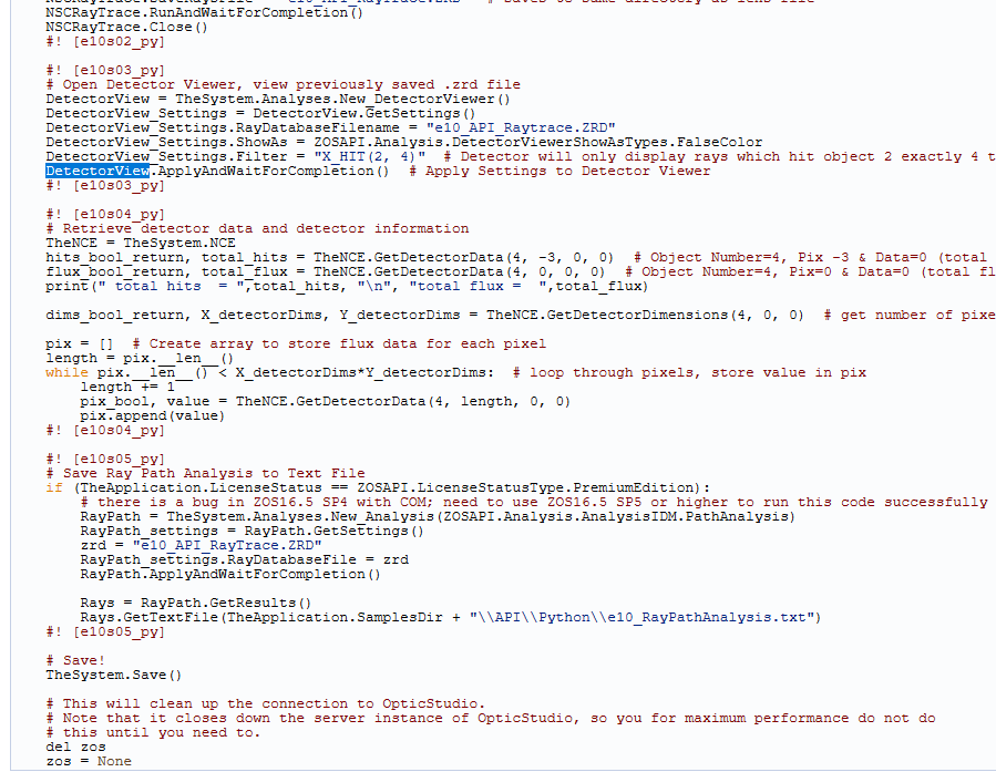

I don’t understand how the example from the API doc show how to use the Dectector viewer, since the code
And once the ApplyAndWaitForCompletion() is executed, no reference to the viewer is done -in other words, I don’t undestrtand what is the output created by lines e10s03…?
