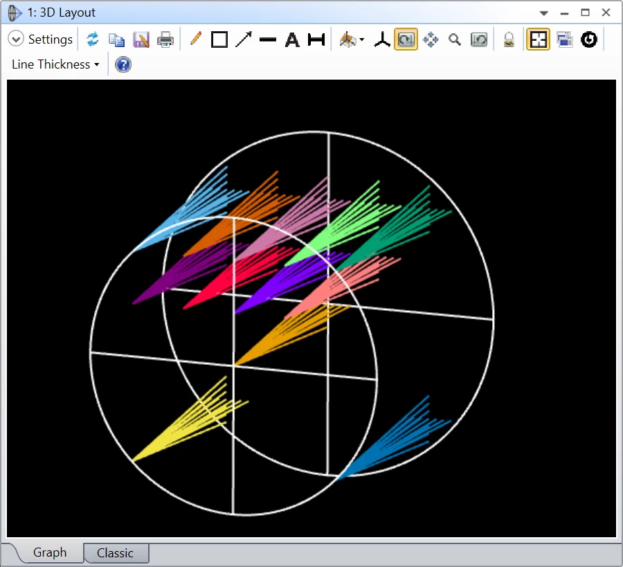

I don’t understand the “fiber source array with a X° facet angle”, but I can make a suggestion regarding “control the number of rows and columns by defining a pitch size in both axis“.
In Sequential Mode, you can setup a grid of fields like so (Field Type is Object Height):
Notice how some fields are shown with a green color, and some with a pale yellowish color? It will be important later.
I used an Aperture Type: Object Cone Angle of 5 degrees and ticked Telecentric Object Space in the System Explorer..Aperture:
The result is as follows:
Notice how some fields are missing in the 3D Layout? It is related to how the fields are colored in the Field Data Editor above. Note the following excerpt from the Help File:
Therefore, in the 3D Layout, you’ll only see up to 12 fields at the same time. You can still visualize the others but not all at the same time (to the best of my knowledge).
This is mostly a visualization thing, if you setup a Merit Function for example, it will still use all the 25 fields.
I guess you could achieve something similar with the Multi-Configuration Editor, and in the 3D Layout, it might be possible to see all 25 fields, but since there’s no Wizard to do that it might be a bit tedious (or you could write a ZPL to do it). I haven’t tried that part since I wanted to confirm I understood your question correctly.

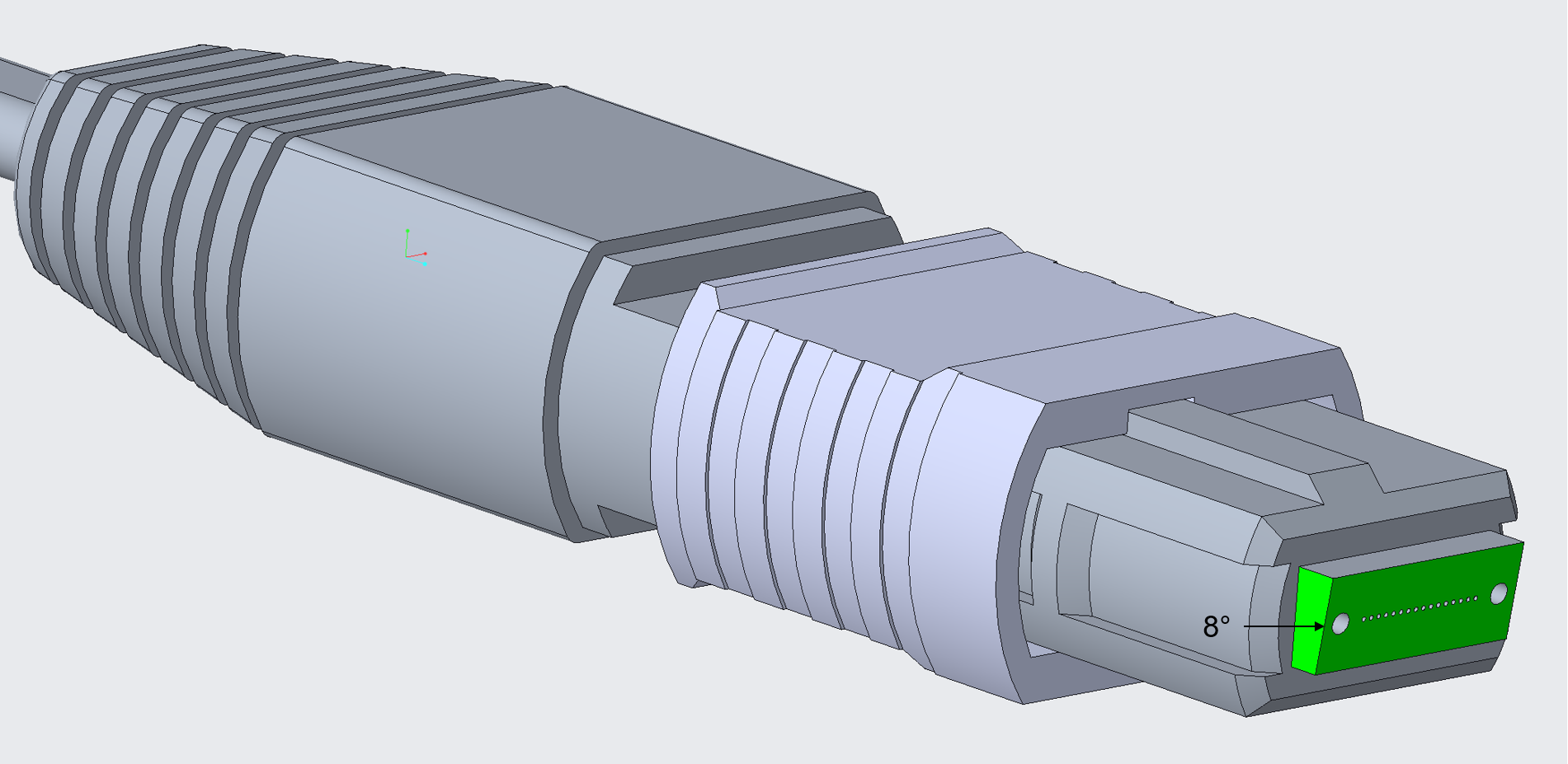

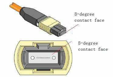

Hello David - I like your approach to my question.
Let me clarify what “fiber source array with a X° facet angle” means: It means an array of fiber such as an MPO connector where the fiber endface is cleaved at 8° to limit back reflections back into the fiber. Below are some CAD representations of a MPO contact face. The face and the fiber endface have a 8° facet.
APC MPO
FIBER ENDFACE CLEAVED AT 8°
I hope this clarifies your doubt.
