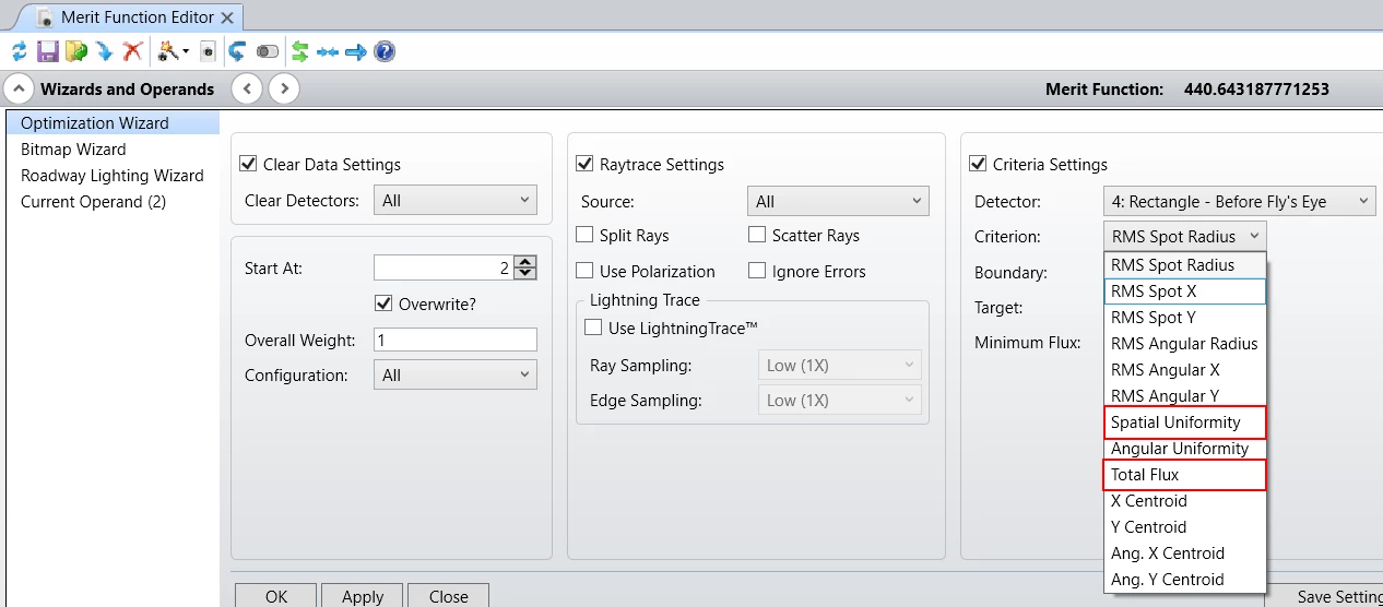

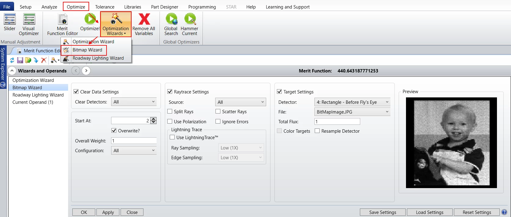

If you have the Premium version, you can the Bitmap Wizard to upload a flat-top image with the desired aspect ratio as an optimization target.  The wizard will setup the Merit Function Editor with the correct NSDD operands to ensure the normalized pattern is achieved during optimization.
If you only have the Professional version, I would look at manually setting up multiple NSDD operands and target Data values like Spatial Uniformity and Total Flux.  Note that the Bitmap Wizard will place a NSDD operand for every pixel on the detector with the bitmap intensity value corresponding to the total flux the pixel should see.  So, for a 100x100 pixel detector, the Bitmap Wizard will add 10,000 NSDD operands for the pixels.
