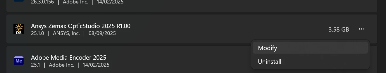

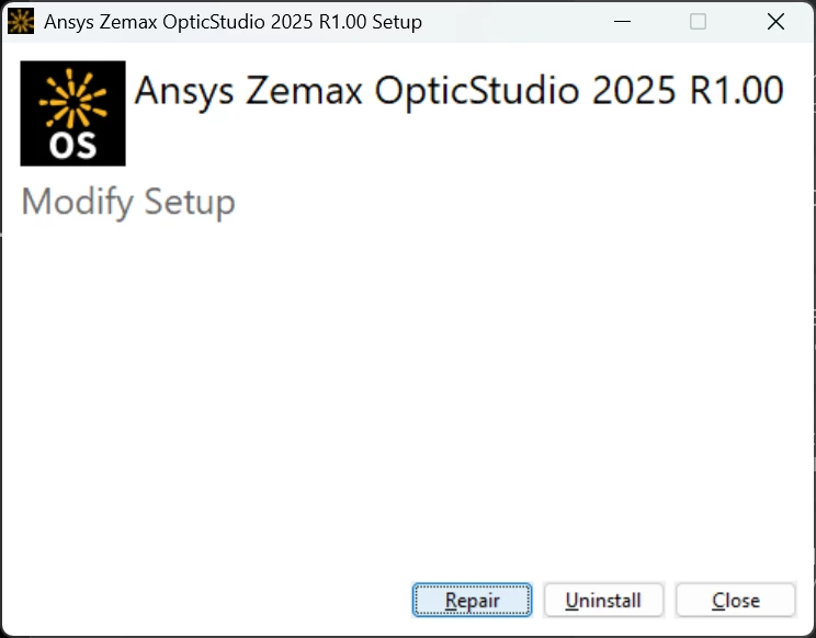

Just wanted to report that I had the issue happening to me today in 2025 R1.00.
I went into Windows’ Installed Apps and clicked on the … on the right-hand side, and chose Modify.
Finally, I pressed Repair, and the issue was solved.
