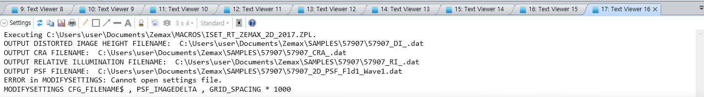

Hi All,
I used .ZPL macro in ISET code.
This code can be extracted the distortion,RI,CRA, and PSF.
However, when I run the macro, multi-wavelengths are not extracted and psf is not extracted with the error message in the capture below.
Could anyone debug these problem?
thank you.

Anyways, simply looking at the error ERROR in MODIFYSETTINGS, did you read those lines of the macro (lines 56-60)?
!   2) For both the PSF output and the grid distortion output, you need to save a .CFG
!      file in the correct directory in order to properly run these sections. The macro
!      modifies the .CFG files in order to ensure proper output and can't do that if the
!      files aren't there. You can simply save this file by going to the correct window
!      in Zemax and saving the settings. (correct directory is the lens directory)
I also suspect this is a problem because the .CFG file isn’t in the ZAR archive that you uploaded.
