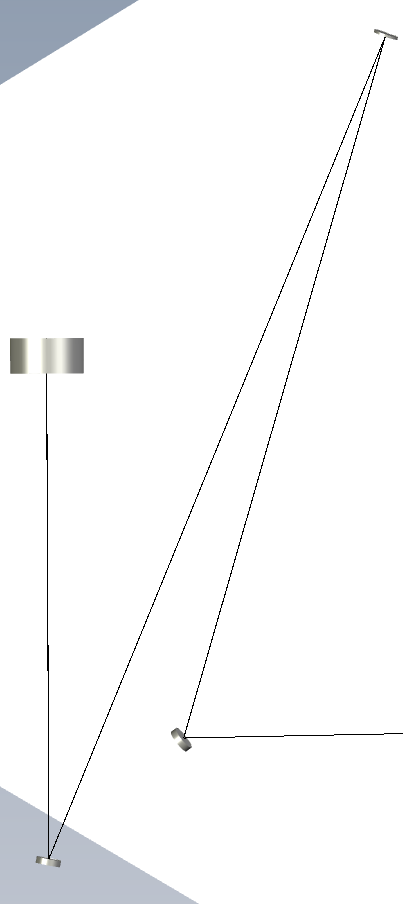

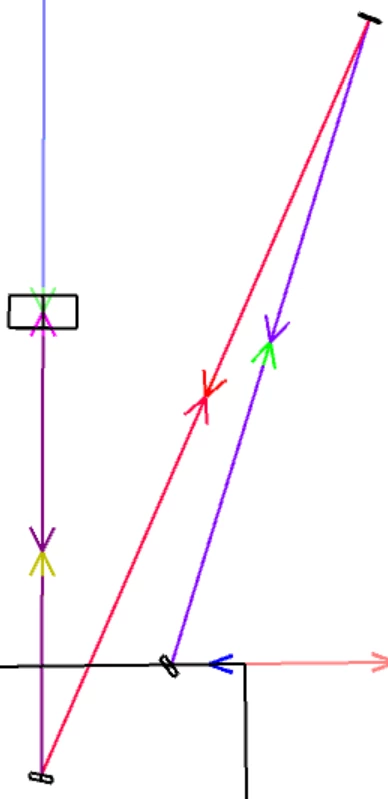

I have an NSC layout in OpticStudio that includes some mirrors and a beam that is modeled as a Source Ray. I see the beam in the layout and I want to export the layout as a Step file. (The layout is it appears in OpticStudio is attached.) When I view the Step file, a segment of the beam is missing. (The layout as it appears in the Step file is also attached.) The segment of the beam that passes through the large optic (light purple in the OS layout) is missing from the Step file and I’m not sure why. I’ve tried changing the source type for the beam, the power of the beam, the coating on the large optic. I even tried removing the optic, but this causes both the light purple and the maroon segments of the beam to be missing in the exported file. Any help would be greatly appreciated.

Just as a follow up, I want to mention that the length of this beam segment is quite long (on the order of 10^5 mm). I’m not sure if there is a limit to how long an exported beam can be? But I tried creating a cylindrical object of the same length as the beam and this object is able to be exported in the Step file. I’m not sure why the beam will not export.

Thanks for your response. To view the STEP files, I am using eDrawings and also OpticStudio (importing the STEP file back to OS).

Based on our tests it seems that the problem is with the eDrawings CAD tool specifically.
All the segments of the ray are drawn correctly in the STEP file when using SpaceClaim or Autodesk Inventor as a CAD software:
I would suggest to try using another CAD software instead of eDrawings.
