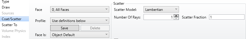

Once this is done, you make the Slide scatter Lambertian, scatter fraction 1, 1 scatter ray:

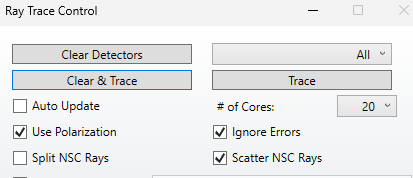

You should be able to see your image if you check the “Scatter NSC Rays” in the Ray Trace Control window
