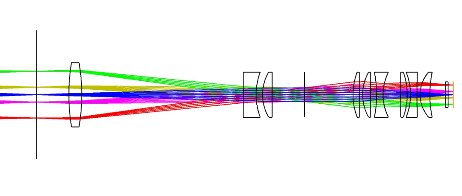

Here is my design in sequential mode:

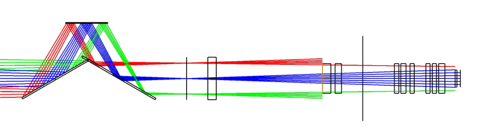

Then I add K-mirror before the lens assembly in non-sequential mode:
AGV_vUdHnj5mkaxLsR-ISMOA98LfcZ9aRr4bspPZ8BUWf2VOTGLfzthdnL4SoX2nG-k7F-wUZT9oBEgCUZ24R65v1JSx-VYfAmujvki24JnLxinAFDLxkKM7rrr1McX4nWURkvtKZJ9TtlM1kMkGYRNrUMb5wxdTkjCz=s2048?key=54XQhJMCOY4xx-YpKaaYhQ
After the mirrors are added changing the curvature of radius of the lens assembly fails. The light is not reflected through the lenses and Zemax draws the lens as large circles. Any clue as to what is causing the issue?

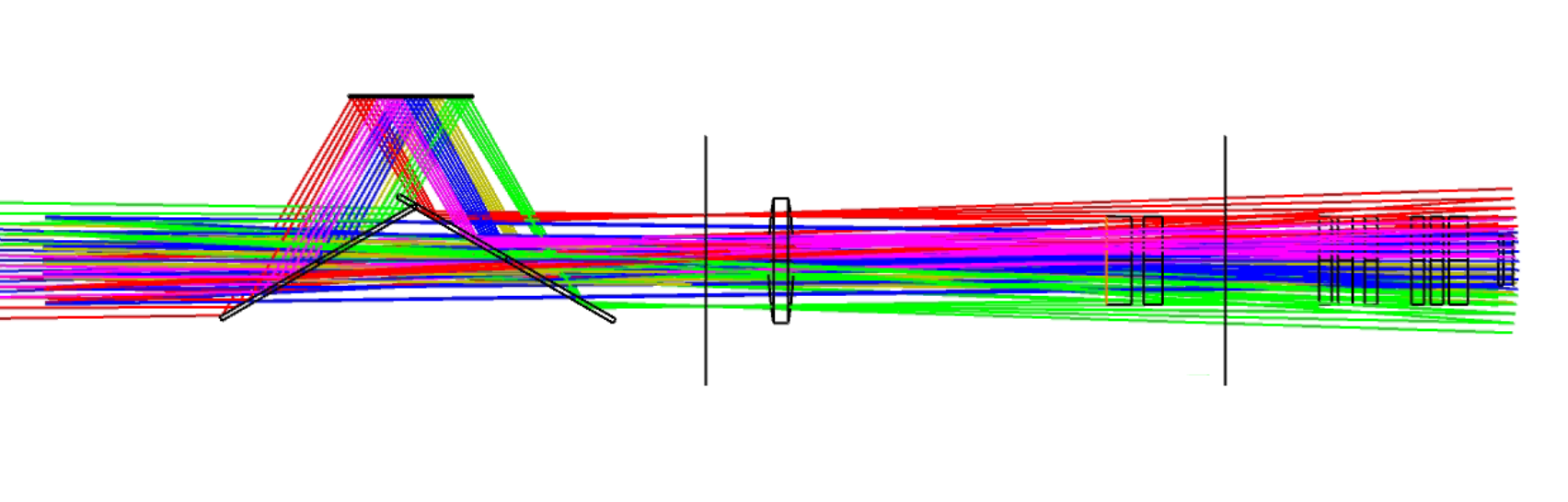

Thank you for your answer! Changing the sign of the curvature does not fix my issue. Checking the lenses “cannot be hyperhemipheric” does help remove the giant circles, but as you can see in the image the light still is not tracing correctly.
I ran the system check and got the error: “Angle of incidence for chief ray exceeds 90 degrees” on the 3rd mirror surface and all the surfaces following. I never used this feature before so thank you for sharing. I can see though that the angle of incidence is not greater than 90 so I am still wondering what causes this problem.

Thank you for your helpful response! The local axis of the third mirror was actually already pointing up. When I rotate the mirrors by 180 the angle of incidence errors go away, but then the system only traces virtual rays in the wrong direction.
I will share my file here:
