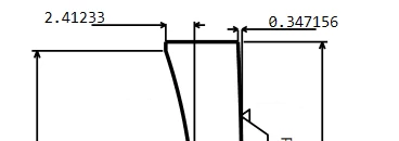

Hi
I am using 2025 R2.02 version. It looks like the issue previously reported about the ISO drawing has been partially solved which is cool (https://community.zemax.com/topic/show?tid=5444&fid=7).
I still have one problem, it’s the number of digits used for the SAG and edge thickness on the drawings.
There is 5 to 6 digits on my drawing.
In the L (R) surf TAB of the drawing, you can uncheck the Automatic box and change the surface sag but it seems to have no effect on the drawing…
Do I miss something?
Renaud

Hi Mark.
I completely agree with you and it’s why I’m looking for a way to reduce the number of digits. My concern is on the sag values that are indicated on drawing and automatically calculated by Zemax. They are printed with min 6 digits and I can’t find a way to decrease it.
Renaud

Hi Jeff.
I agree. Concerning this specific issue, I’ve created a case and it has been identified as a bug. It should be resolved in a future release I hope.
