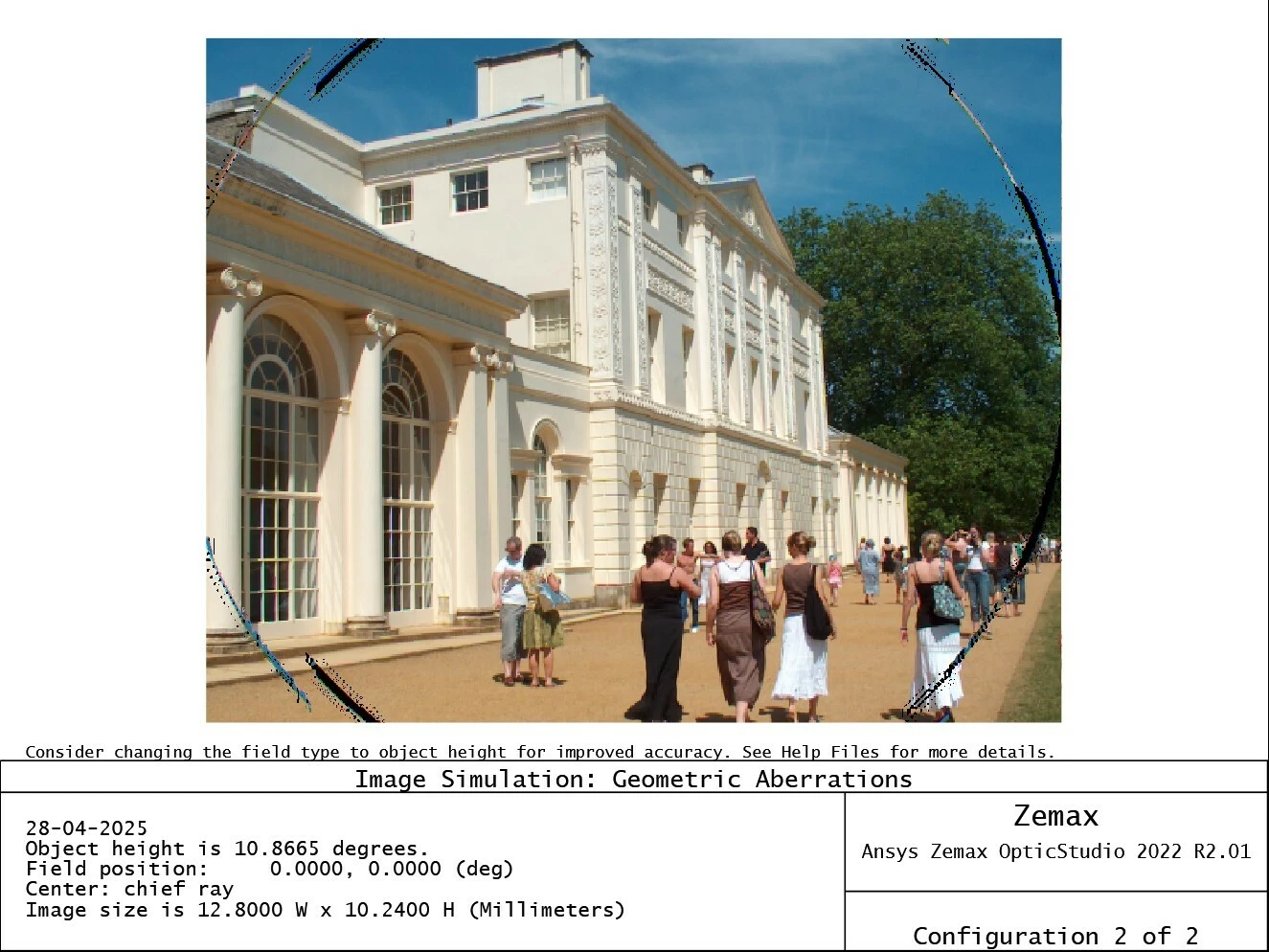

I am facing an issue in image simulation for my designed IR system which is showing a circular ring like patch. I am not sure whether this is an image simulation issue or there is some actual error in the system which is being reflected in the image simulation.
The design also includes binary surfaces for chromatic aberration correction.
Attached is the image simulation result.
Any help is highly appreciated.
Supravat.

Do you happen to have ray aiming turned on?  I’ve seen a similar effect under a certain set of conditions when paraxial ray aiming is on.

Hi Jeff,
Yes, in this design paraxial ray aiming is on. I have checked with ray aiming off, when ray aiming is off this circular ring effect is not there.
So, what I understand this is not a design issue rather some ray tracing error.

Hi Supravat.  Yes, this is a bug associated with paraxial ray aiming.  If you need ray aiming to correct for pupil aberration, you can try using the “Enhanced Ray Aiming” option.  It might help, but it is rather slow, so Image Simulation may take a while.

Hi Jeff,
By using "Enhanced Ray Aiming" aslo same issue arises. But, Circular Ring effect is not there when, I unchecked "Automatically Calculate Pupil Shifts" with the Paraxial Ray Aiming on.

Interesting.  In my case using Enhanced Ray Aiming solved the problem.  In any event, I found that this ring-like artifact occurred when the following three conditions were all simultaneously present: (1) paraxial ray aiming was on, (2) the auto pupil shift feature was selected, and (3) both x and y fields were defined.   When either turning off the auto pupil shift or defining fields only along the x or y direction (but not both), the artifact would disappear.
Hopefully the development team can visit this issue and try to correct it.
