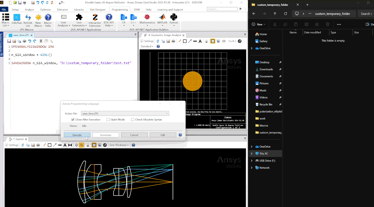

I tried your macro snippet on the Double Gauss sample file. It wrote a 3.8MB file nearly instantly. I have a relatively good computer but to think it could take 20 seconds, there must be something else to it.
Are you able to share your file and full macro? Do you notice if there are other things in your UI that get updated that could slow everything down?
