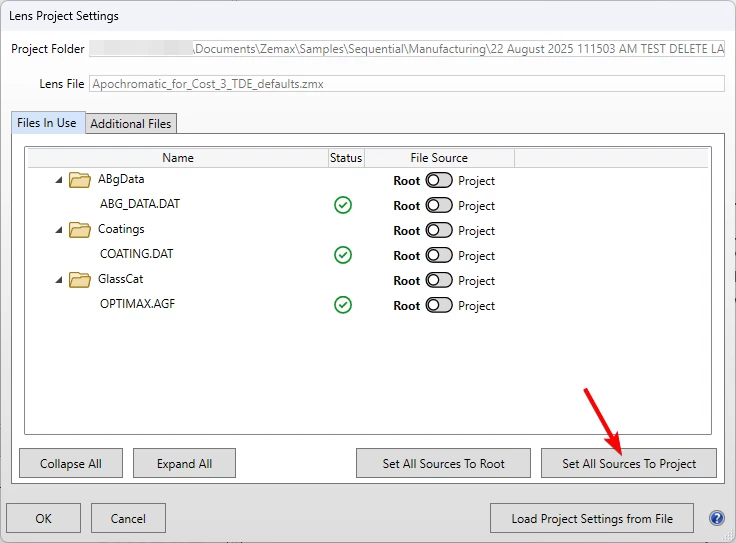

  • Aug 22, 2025 3:17 PM UTC
​@MichaelH Nice! But once I save the system to Project Directory - how do I set all dependencies/sources to the Lens Project Root Folder?
Similar to this action in  the GUI.
