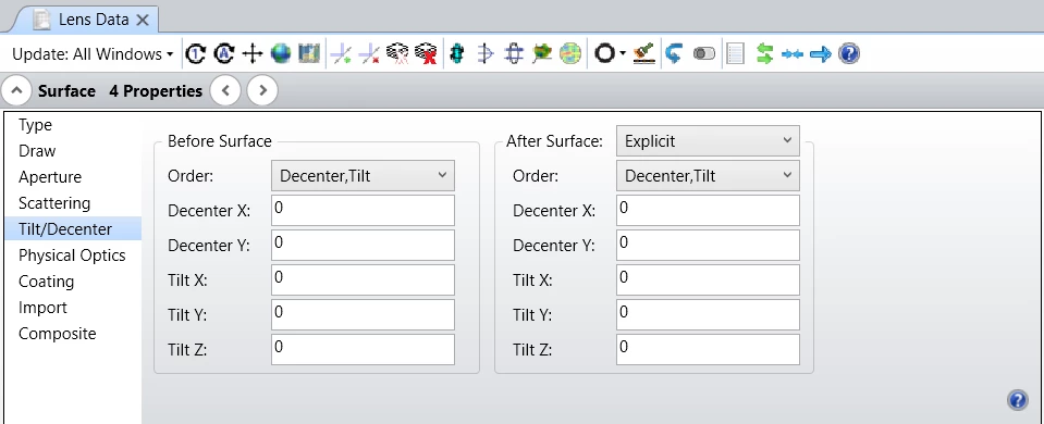

The thissurf.TiltDecenterDataBeforeSurfaceTiltX refers to the following surface property from the LDE:
This is not the Tilt About X or Tilt About Y that you would use with a Coordinate Break in the cells of the LDE.  Rather, you should use the following (pseudo) syntax:
print(thissurface.SurfaceData.__implementation__.TiltAbout_X)
(note, the __implementation__ is only required for Python but should be removed for other languages)
