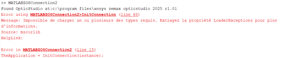

Hello everyone,
I can't connect Zemax and Matlab since I installed the new version of zemax 2025 R1.01.
I am using Matalb version 2019a Updates 9 and it worked with previous versions of zemax.
The error in question
Unable to load one or more of the required types.
My two applications are installed in 64bits
I've already tried uninstalling and reinstalling the applications.
Thanks for your help
