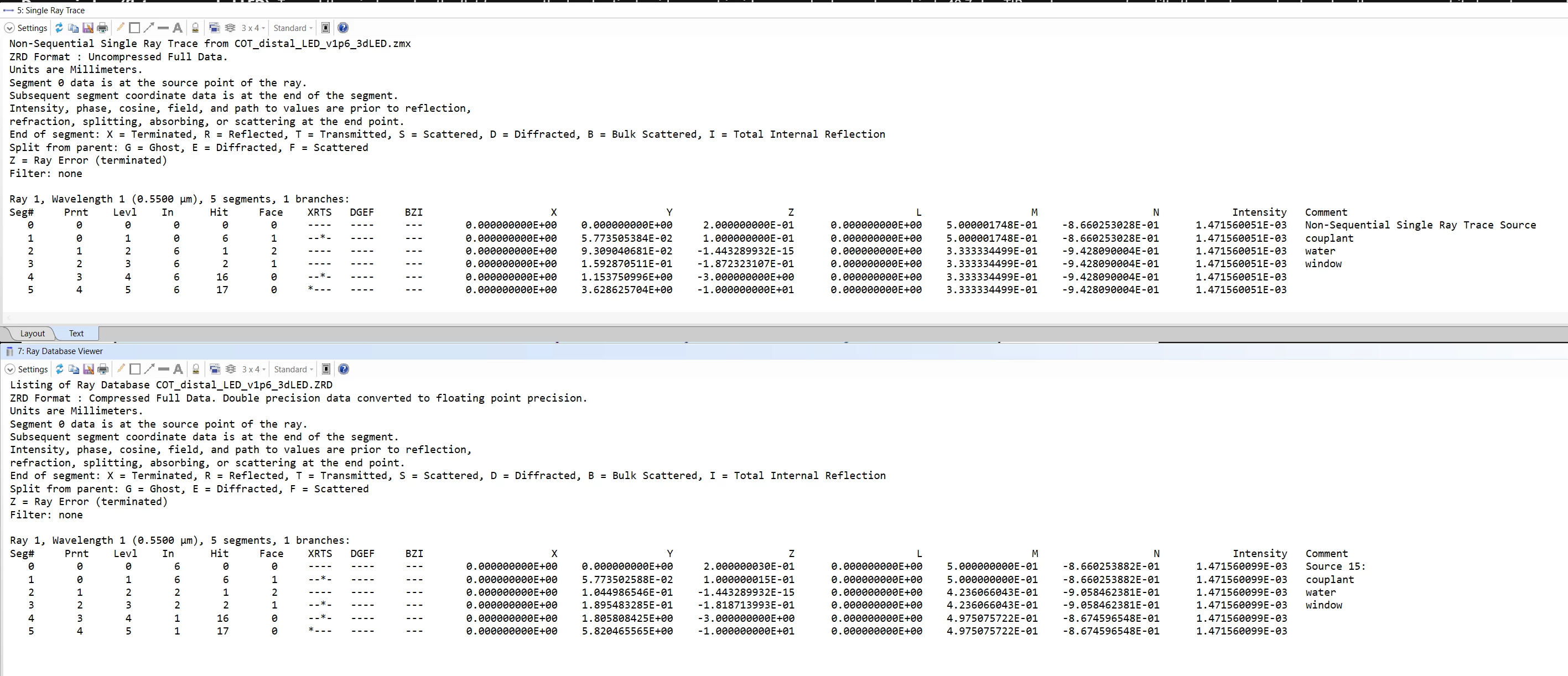

I’m not seeing how you can use this tool to launch a ray inside of an object. When choosing a reference object, it inherits the position, but not the ‘Inside Of’, and launches the ray inside object 0.
Below is a screenshot with the new single ray trace on top and on bottom is a single ray saved and viewed in ray database viewer. I’d like the top to match the bottom.
Thanks in advance for any help.
