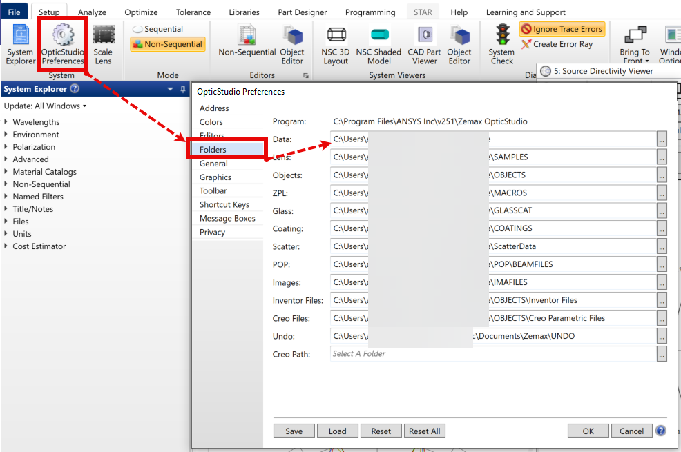

Hi Farz,
Is the file you’re opening a ZAR, or a ZMX/ZOS? Also, when you copied the DLL into the directory, did you confirm it was the correct directory? You can navigate to Setup...OpticStudio Preferences...Folders to confirm which folder Zemax is using to find your DLLs:
