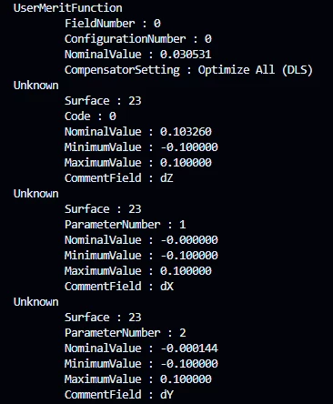

Thank you for the code example. I was able to retrieve all column names from the ZTD file but the code returns “UNKNOWN”  for “COMP” columns. Is this a bug?
-asuku
