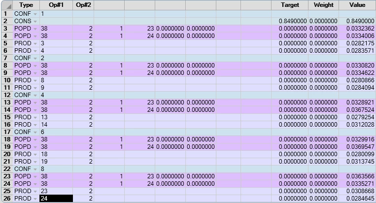

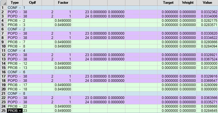

I wanted to multiply the beam X and Y widths from POP by a constant (to have the FWHM) and thought I could use PROB for that. Here is what the merit function returned:
No issue with the POPD computation. However, as you may notice on rows 14 and 20, Zemax thinks that 0.0328921 and 0.0369547 multiplied by 0.849 is 0.

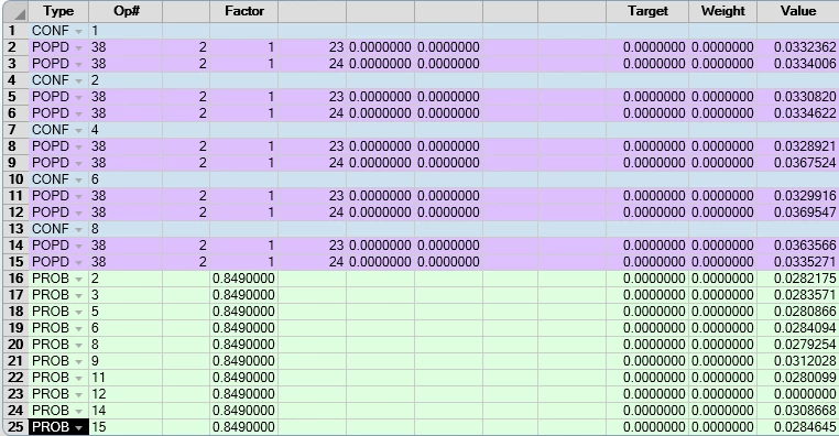

I decided to move the multiplications as the bottom all together (tried with and without a CONF 1 without change) and found that Zemax is still confused (at row 23)

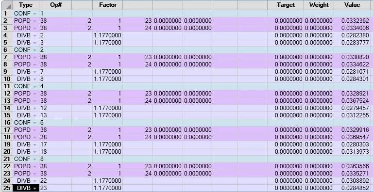

Here are the 2 workarounds I have found:
1- instead of multiplying by 0.849, divide by its inverse (1.177). DIVB seems to be fine with it
