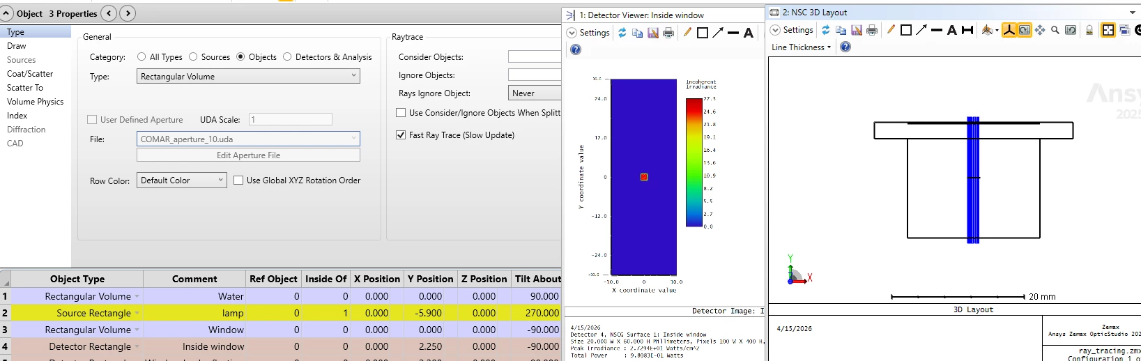

I am building a non-sequential model and have observed unexpectedly high back reflection from a surface with an I.98 coating.
I have attached the Zemax file for reference. Two detectors were placed just before the surface: one records rays propagating toward the surface, and the other records the back-reflected rays. Based on the I.98 coating, I would expect only ~2% reflection. However, the results show that nearly 50% of the light is being reflected.
Has anyone encountered a similar issue? Could there be a reason why the coating appears to be ignored in this setup?

It seems to work if you use rectangular source:
I  think in your case some rays reenter from the other side and count as negetive intensity.

Thank you Nadav.
I did try more to figure it out. It looks like the conflict of the source and the water volume is the issue. I used Boolean Native instead and the result now makes more sense.
