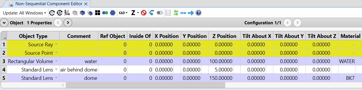

Hey Joel,
To get air behind the concave portion of the dome, you can use another Standard Lens and simply leave this new Standard Lens’ material as blank (which implies air). Make sure this lens is placed above the dome lens in the NSCE so the rays will actually see the BK7 material of the dome:

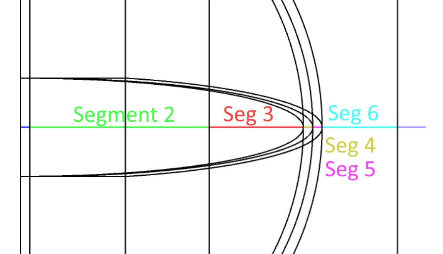

If you look at the NSC 3D Layout and change the Color By to Segments, you can see each segment on the layout. I have added some text to label the segments. You can see that there are now 2 segments inside the dome lens (gold and magenta) rather than 1 because the new Standard Lens representing the air is causing the ray to split one extra time in the software:

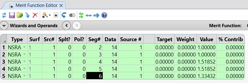

Now, if you look at the NSRA
operand, you can see that Seg 2 & Seg 3 are in air (1.0), Seg 4 & Seg 5 are in BK7 (1.518) and Seg 6 is in water (1.334):
