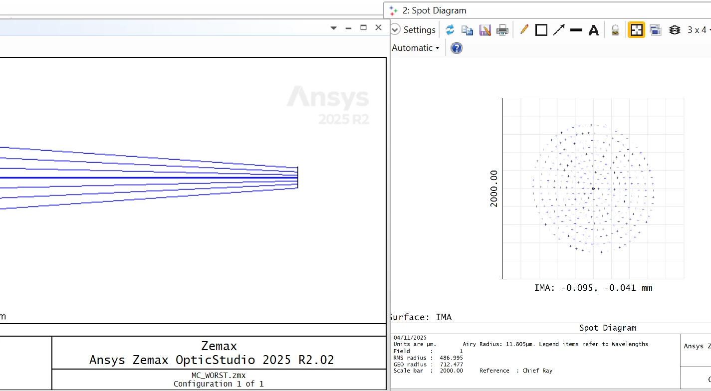

Hi, I’m re-opening this topic: today, when performing tolerance analysis, while “use focus compensation” is selected, if I run the tool and then open the MC_worst file, I can see there is no refocusing!
Anybody has an idea?
  • Nov 4, 2025 4:58 PM UTC

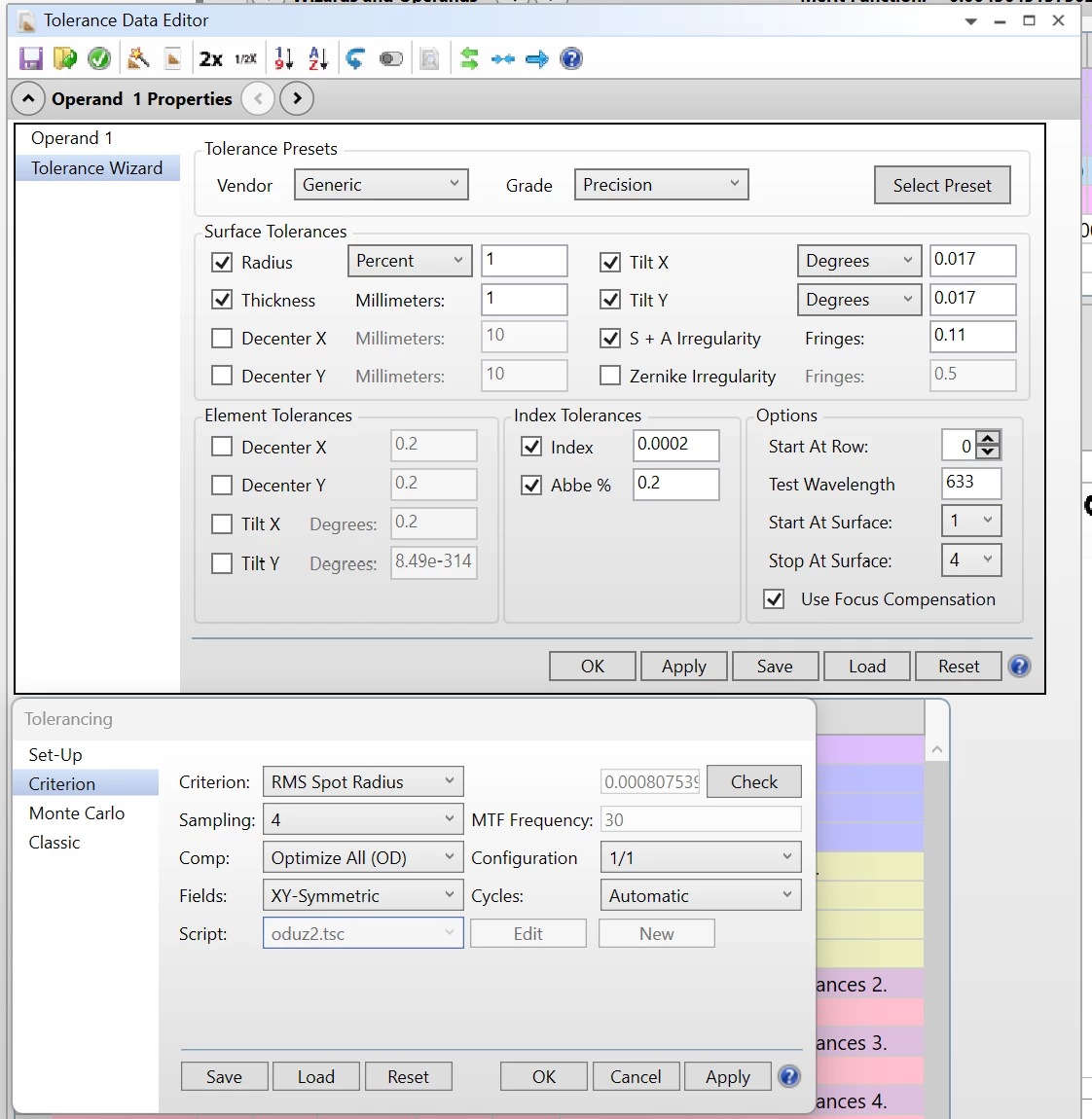

Hey Julien,
Do you have a COMP defined in your TDE?  I can’s see what is actually defined but a COMP would be a light blue color and your TDE starts with what looks like a TWAV followed by TRAD  & TTHI operands.  You can consider a COMP as a variable during tolerancing.
Also, it looks like you’re defining your test wavelength as 633um, not 0.633um.  I would double check that this is the wavelength that you want (OpticStudio only deals in microns, not nanometers).
If you can upload your file, someone can better diagnose what is actually going on with your file.
Julien Dejonghe
Indeed, I don’t… So it is probably the reason why the back focus is not adjusted correctly. About the wavelength, you are right, I should have entered it in microns. By the way, when re-opening the TDE, the test wavelength is set at zero, I don’t know what it means. My understanding is that the test wavelength used for tolerancing is not necessarily the same as the one used in the system (my design here is centered on 1.35), ami right?
Below is my current TDE, I will add a COMP and try again, but I have another question: A merit Function can be used as a criterion, but I believe it is not the same Merit Function I used to optimise the design, so where do I define the Merit Function for tolerancing?
Thanks
Julien
Julien Dejonghe
Doesn’t seem to work… I added a compensator, but it disappears if I click on apply or save in the TDE. I tried it anyway and the focus wasnt adjusted when openig the MC_Worst file. I am obviouly missing something! Attached is the zemax file.
  • Nov 5, 2025 1:55 PM UTC
For the COMP, the Min and Max are delta values, not absolute values.  So, when you have your COMP 5 nominal at ~232.83mm, you should set the maximum deviation from this nominal value.  You have the Min set to 230 and the Max set to 236, meaning OpticStudio is targeting the compensator value of between ~462mm and ~468mm.  These values should be -2 & +4:
I would suggest saving 1 Monte Carlo file and opening it up to see what OpticStudio is actually doing to the modified system.
In your case, you can see that OpticStudio is properly adding the variable to Surface 5 but then when you look at the Merit Function Editor, you have a CTLT and CTGT targeting the improper min & max values you had set.
As for the test wavelength, this is used to determine the number of fringes for other operands like TFRN or TEXI; this is needed to convert from fringes/waves to physical values like nanometers.
Julien Dejonghe
Ok thanks, I used -10 and +10 for the Min and Max values for the compensator, it works well. Anyway, this COMP operand keeps being erased if I click “apply” or “ok” int the TDE, which is a bit annoying.
