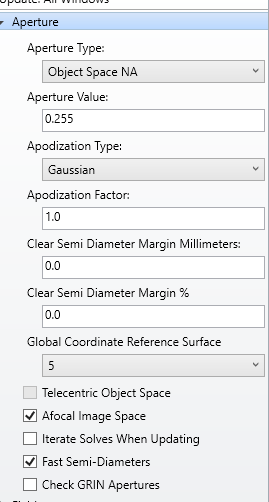

After following the next article: The easiest way to tolerance an off-axis mirror
I have been struggling to manage the tolerances in my system since it has 2 different OAPs and as in the example, I have set one of them as the global coordinate reference
Apart from that issue, I really don't think my coordinate breaks are working properly to tolerance the OAPs (I only want to check the decentered and tilt tolerances).
Lastly, I don't really know why final focus is not hitting the center of the image.
Thanks
