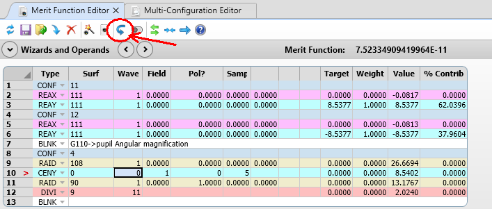

Maybe it’s just me, but I am no more able of opening the “Go To Surface” popup window from any Editor.
The following does not come up (image taken from Help file):
I am using opticStudio version 2025 R1.00

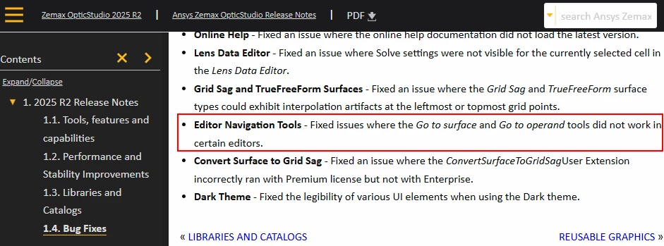

Hey Alberto,
The Bug Fixes have moved recently to the Ansys Help portal (it would be nice if OpticStudio included these directly in the software like they do with What’s New).  The issue with the Go to surface and Go to operand dialog boxes were marked as fixed in the 25R2:
https://ansyshelp.ansys.com/account/secured?returnurl=/Views/Secured/Zemax/v252/en/OpticStudio_release_notes/OpticStudio_release_notes/topics/bug_fixes.html
To get to any of the Bug Fix reports, once you’re logged into https://ansyshelp.ansys.com, navigate to Zemax OpticStudio, click on the desired release in the upper left corner of the screen, click on the Release Notes link, then click on Release Notes again and then select Bug Fixes
