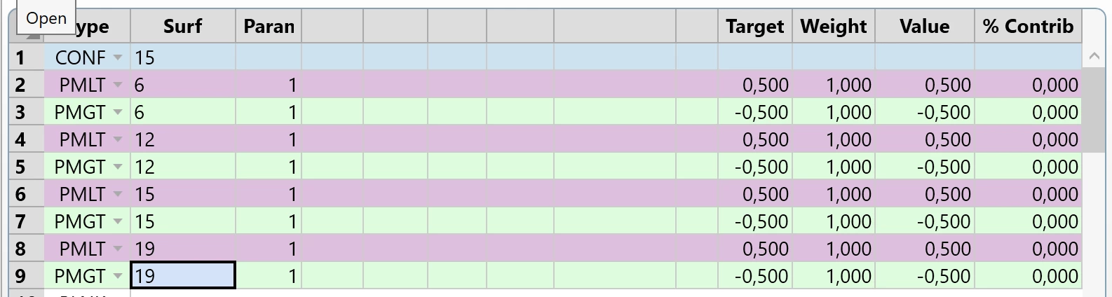

I am trying to set boundaries on longitudinal compensators on my tolerancing analysis with Monte Carlo runs. As I am using a Merit Function criterion, the boundaries (from what I understood), must be explicitely defined in the Merit Function tab with the PMLT and PMGT operands for each surface that acts as a compensator. I did set them, as you can see in the next screenshot.

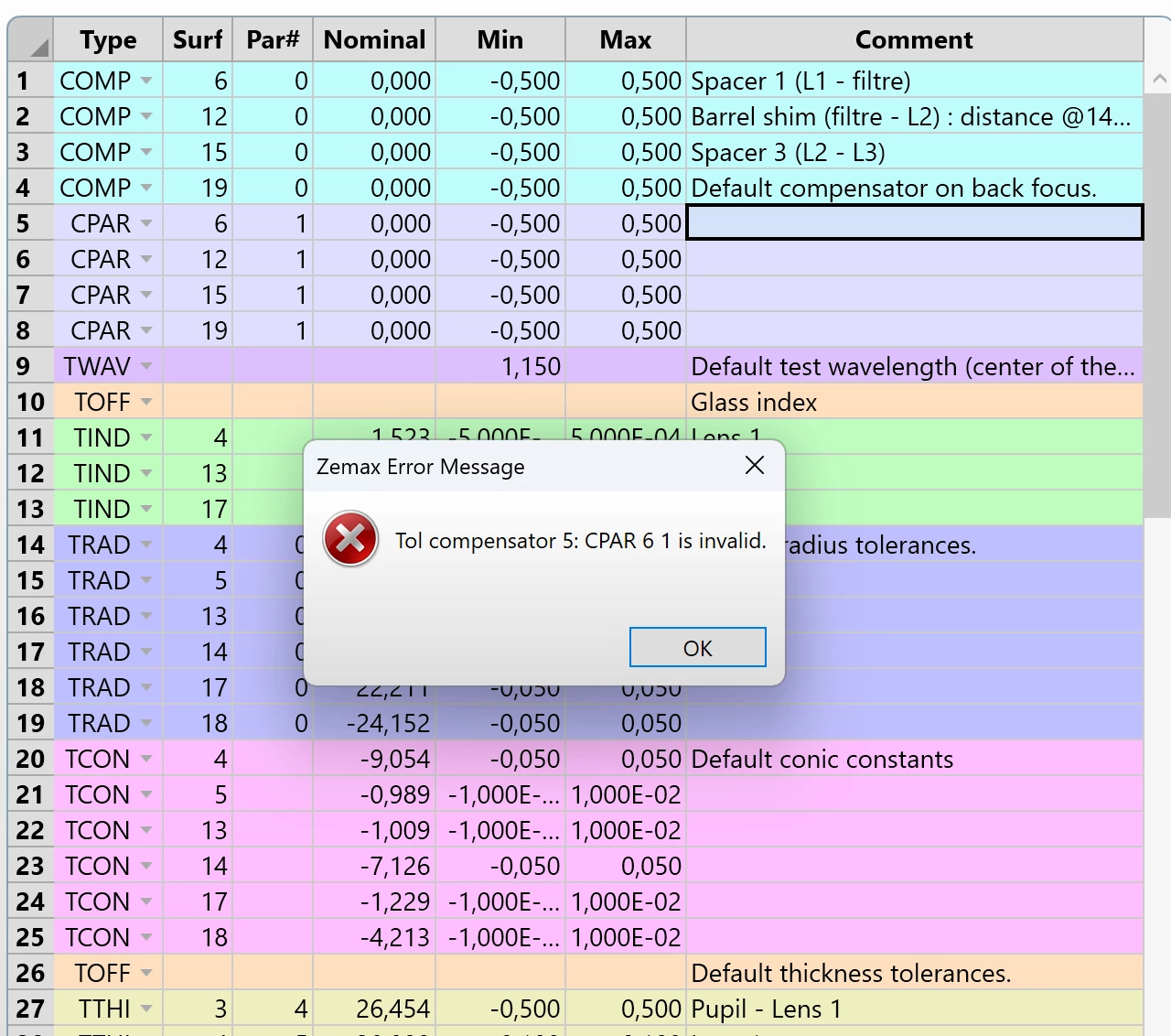

I also declared the compensators in the Tolerance Data Editor (2nd screenshot), by using the CPAR operand (I found a topic on the forums explaining that it was the method to follow). I declared the 4 compensators I wanna use (I would like to use the thickness of these surfaces as compensators), so I did use the #1 parameter. But when I try to run the tolerancing, the error message appears (CPAR 6 1 is invalid). Would you know where this problem comes from? Maybe I am not doing this the right way or there is another method to do so.

Best answer by Chris Normanshire
Hi ​@superkraken. Are the surfaces you are attempting to use as compensators Standard surfaces? If so, the reason you are seeing this error is because you are trying to use Parameter 1 as a compensator, but the Standard surface type doesn’t have any additional parameters.
More complex surface types do have additional parameters that are used to define the surface sag, phase, etc.
If you want to apply a compensator to the thickness of a surface you need to use the COMP operand with Code = 0, as with lines 1-4 in the screenshot of your Tolerance Editor. You should delete the CPAR operands (lines 5-8).
In the merit function, you can use CTGT and CTLT to places boundaries on the thickness of a surface.
You should delete the PMGT and PMLT operands from you merit function and replace them with CTGT and CTLT.

Chris Normanshire
I hope this helps.
Chris

Hey ! Thanks a lot, it seems to be working now :D
In fact, I already tried to apply such a method but it didn’t work out in the end. It is very likely that the weight on the boundaries was not big enough. I multiplied everything by 10 and now it seems to fit inside the boundaries.
