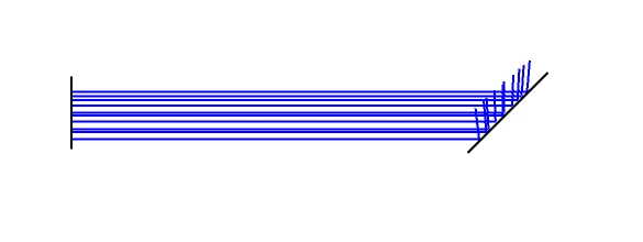

I am trying to model this OAP from thorlabs in zemax: Thorlabs - MPD269-G01 Ø2" 90° Off-Axis Parabolic Mirror, Prot. Aluminum, RFL = 6".
I am able to open in sequential mode, but when I want to convert it to non-sequential mode I get this (see below)
This happens when I do design lockdown or not.
I also want to swap the light source and imaging plane so the source is a diverging point source at the focal point and the light is a collimated beam off the OAP.
Any and all help is appreciated, thanks!

can export  OAP to a CAD file like STEP in sequential mode, then import it to non-sequential mode?
Travis3
  • July 31, 2025
I tried to do that and the mirror surface is missing from the step file. The body is in the step file but it is hollow.
  • August 1, 2025
Have you tried uncheck parasolid or acis library in project preference, then re-export it as a step file and import to non-sequential mode?
  • August 1, 2025
@Travis3:
You can also make the OAP yourself in non-sequential mode.  This link may be helpful:
