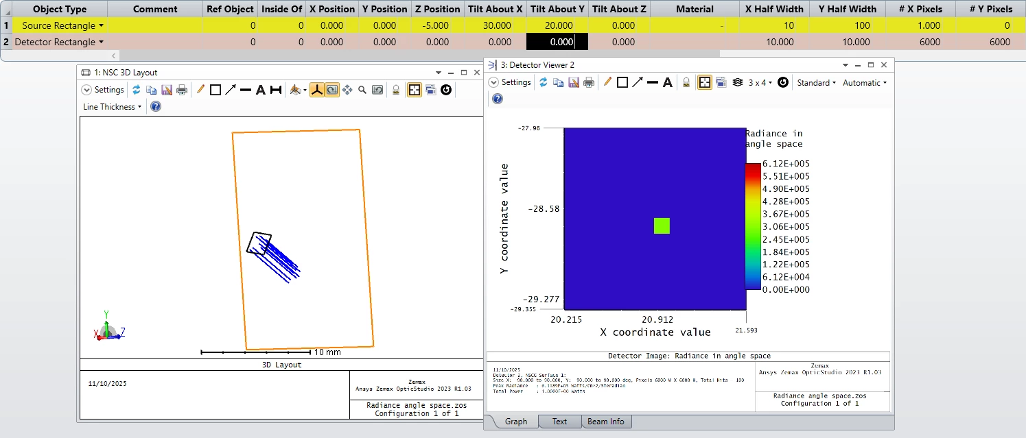

Hi All,
I am modeling optical system where there is a need to know the angles of the propgating rays after reflection, diffraction etc.
However, when using the Detector viewer/radiance space, I found different angles than anticipated.
For example, propagating free rays with tilt x 30, tilt y 20- I got: 21, 28.8 at the detector(attached here):
What happend?
Thanks,
Nadav

Hi Nadav,
The Tilt About X and Tilt About Y cells act upon the local coordinate system of the object, so if you have both an X and Y tilt, you need to consider the final compounded tilt to get the actual angle the rotated local coordinate makes in global space.
The following Knowledgebase Article provides an in-depth discussion of rotation angles in OpticStudio:
https://optics.ansys.com/hc/en-us/articles/42661777200403-Rotation-Matrix-and-Tilt-About-X-Y-Z-in-OpticStudio

  • Nov 17, 2025 6:04 PM UTC
Hi Nadav,
Going back to your original question, if you want to know the angle of a ray after reflection, diffraction, etc., you should look at the direction cosines of the ray and the normal vector of the object the ray hit.  You can calculate the angle of incidence using either multiple NSRA operands or you can use a ZRD with the Ray Database Viewer.  To get the AOI, you simply take the dot product of the direction cosines with the normal vector:
Since OpticStudio always normalizes both the direction cosine and the normal vectors, the denominator is always 1; also, if the Detector Rectangle is pointing in the z-direction (no rotation on the Detector Rectangle), then the n_x and n_y portions of the normal vector become zero and the AOI simplifies to:
This can easily be calculated in the MFE for a single ray for both sources:
If you use a Coordinate Break in sequential mode with both a (45°, 45°) and a (30°, 45°) tilt (in 2 different configurations), you will get the same AOI when you use the RAID operand:
So there is agreement between sequential and non-sequential modes in terms of rotation angles; note that in sequential mode, the angles are negative because we need to make the Image Surface the GCRS so the common reference between both configurations is the image plane, but this doesn’t affect the AOI calculation.
In your scenario, you said you want the angle after refraction or reflection, so you’ll need the segment after the ray interacts with the object (NSC will provide the direction cosine before refraction or reflection).  The following KBA talks about calculating the angle of incidence in non-sequential mode:
Is an angle of incidence report available in the Ray Database Viewer? | Zemax Community
As for the values being reported in the Detector Viewer, these are the projected solid angles on the Detector Rectangle, not the propagation angles of the rays.  The following KBA talks about how the angular data is calculated for the Detector Viewer Radiance in Angle Space.
