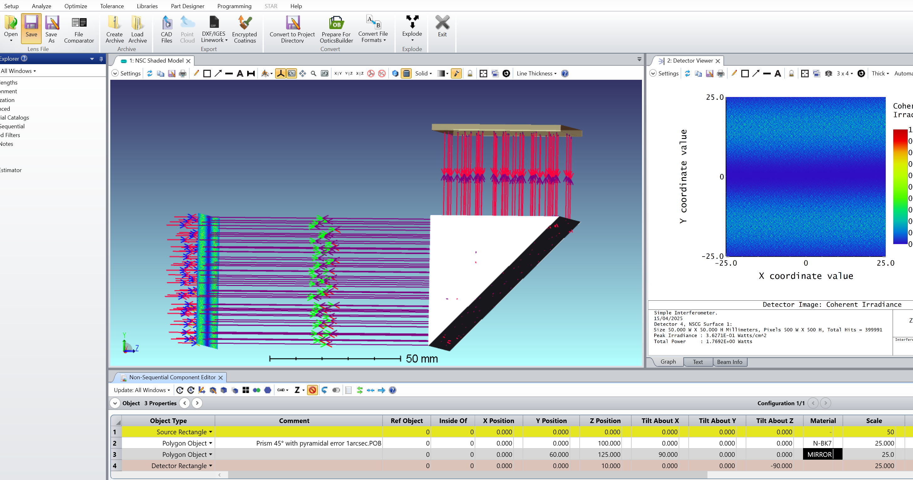

Hello
Using Interference Example 1- A Simple Interferometer from SAMPLES folder I created a simple setup to test a right-angle prism with pyramidal error. At the end I wanted to save the file but OS just froze and didn’t react any more - even after a longer time. I ended the program in Task Manager and opened it again without problem. The file to-be-saved before seemed to have saved well and it was possible to continue the work. I tried to save again and OS froze again. And so many times… In my last trial I wanted to check Preferences and after some time in Preferences OS froze again.
All other sequential and non-sequential files that I have behave normally.
What could be the reason. Attached is the screenshot of the file.
Thanks, Dusan

Addendum 😏
If I delete detector rectangle the problem doesn’t exist any more.
It came to my mind that the rays from the source rectangle pass detector twice i.e. we might have a data overflow. But reducing the number of analysis rays and number of pixels doesn’t solve the problem. Placing detector as a first object also doesn’t work.
Any idea on where to place detector in order to avoid double-pass of light?
Thanks, Dusan

Hi David
Excellent, if you could do that. Please, open detector viewer and perform raytrace (clear and trace) to get coherent irradiance on the detector. One should get approx. 3 fringes. I intentionally reduced number of analysis rays and detector pixel count in order to prevent data overflow. I thought it could happen as the rays pass the detector twice. Ideally, detector should be placed left from the light source but this doesn’t work.
Whatever - when I now click on SAVE or SAVE AS the OS obviously saves the file but in that moment also freezes. What could be the reason? If I delete detector from the setup everything works fine again…
Thanks, Dusan
  • April 23, 2025
@Dusan
There are only three objects in your ZMX, I’m not sure how you generate the fringes:
Are you sure you uploaded the right file?

  • April 23, 2025
Hi David
It works with me. Reference WF is the front face of the prism (4%, Fresnel refl.) and the exit surface of the prism is reflective (index 1 in POB definition of this surface).
But: can you save the file?
