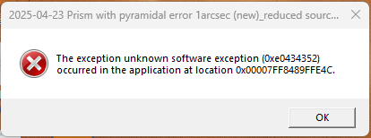

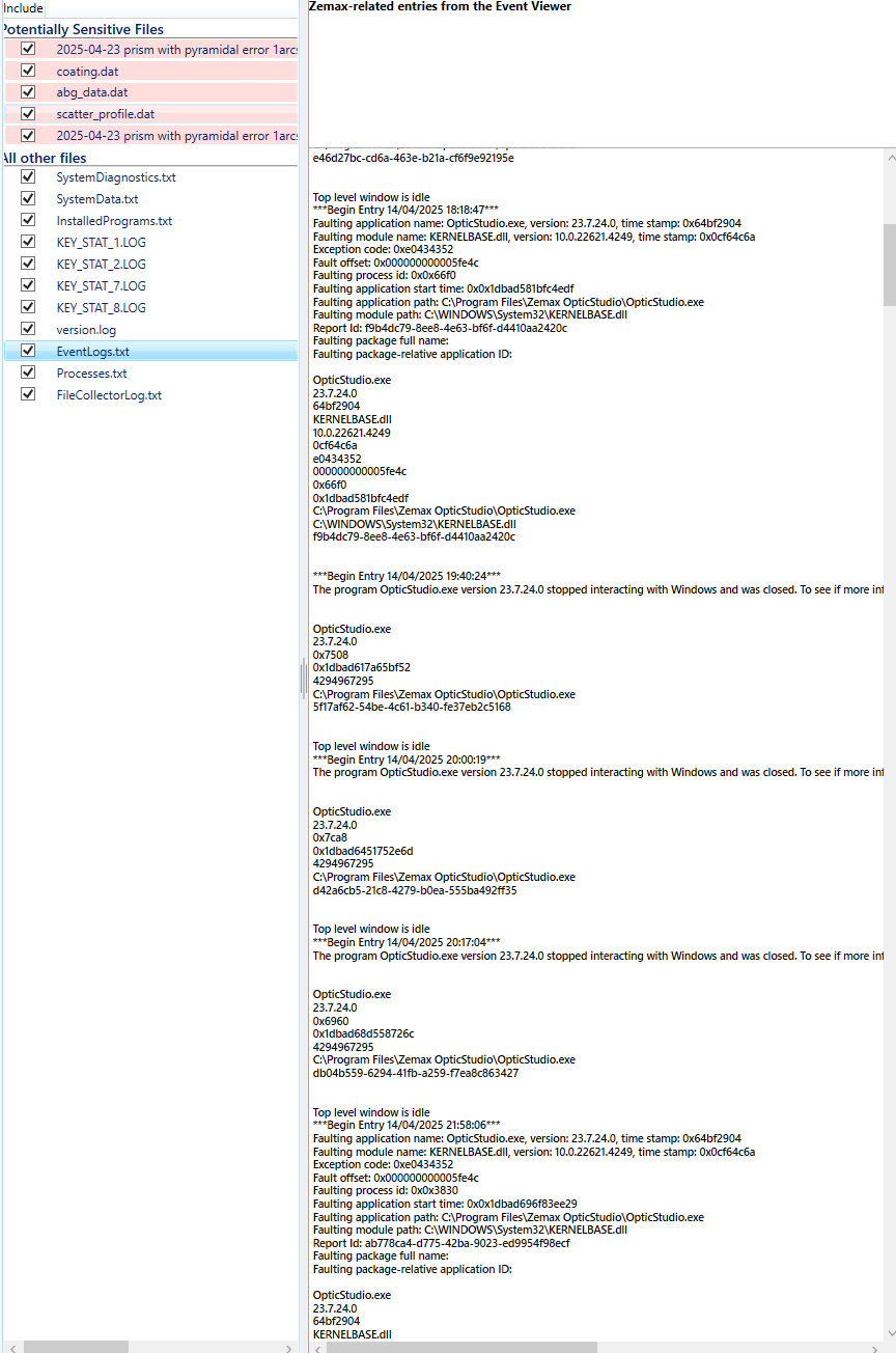

Hi Allie
Thank you for jumping in.
Which part of the File Collector would be most useful? I am attaching a part of the Eventlog (14.04.2025, when it all started) and an error message from this morning.
Kind regards
Dusan

Hi Allie
On my laptop with OS 23.2.1 I don’t use any cloud services. OS is installed locally in C:\...Documents\ and all the files are on an external SSD drive. As a test I copied the troubled file directly to laptop but the OS still freezes.
Sadly, I yesterday noticed that also other NSC files with detectors started to freeze, which they have never done before.
I am attaching the Event Collector. The wording “faulting application” makes me worried !?

Hi Dusan - the term “faulting module” or “faulting application” is just the terminology used by the Event Log. It doesn’t mean anything beyond telling you which application crashed, and what component of the application was at fault. Looking at your logs, there’s not too much information. KERNELBASE.DLL and the resulting error code are pretty generic.

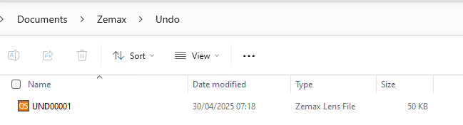

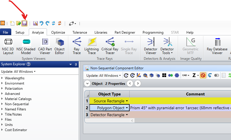

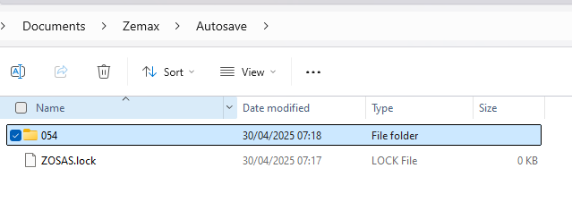

Hello Don
Thank you for stepping in. I deleted everything, but it didn’t work. After running OS again it froze and I am attaching the contents of Undo and Autosave folders after the freeze. One photo shows the moment of “Save”: The “Save” button has a frame and that’s it…
Kind regards, Dusan
