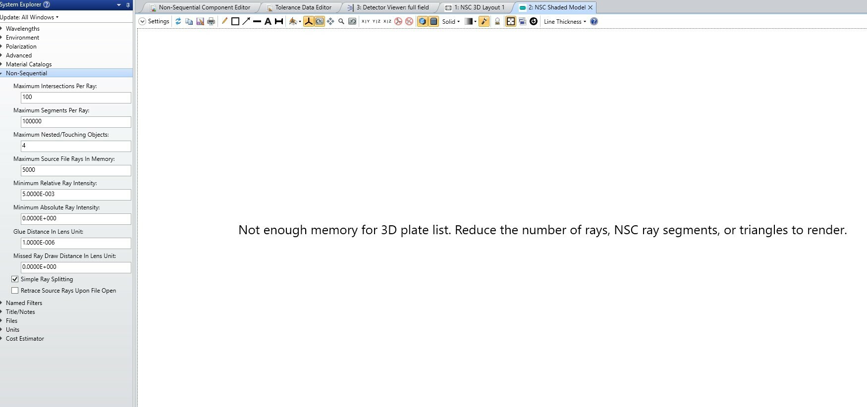

Not enough memory for 3d Plate list even after having enough memory!
  • Dec 12, 2024 2:53 PM UTC
  • 208 views
Dear All,

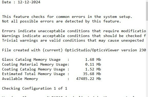

   I am getting not enough memory for 3d plate list error even after my System has enough Ram available. I have attached the screenshots. I was trying to do the stray analysis but unable to do due to this error. Please help me. Thanks,
​@Aaditya.Sarda
I’m not sure what the Estimated Total Memory Usage in the Setup..System Check actually considers. Any chance you can share a file with us? Have you tried doing what the error message suggests and if so, what result did it have?

In your file, System Explorer..Non-Sequential Maximum Segments Per Ray is set to 100 000.
If you reduce this value to at least 10 000 (500 is the default). You get your Shaded Model back (I had to switch to a different tab and come back to it, it wasn’t enough to update the window):
If we color the Shaded Model by segments:
We can see that you don’t have that many segments anyway. Is there a particular reason you set this value to 100 000?
