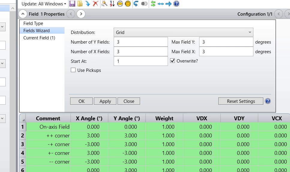

for field  maybe this helps, but needs a distribution combination

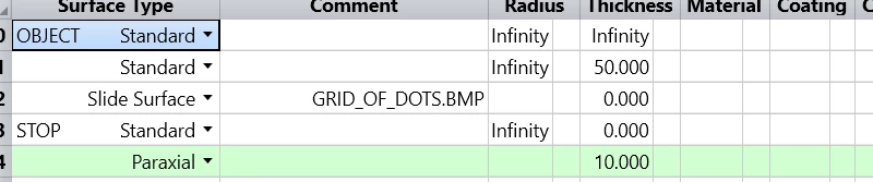

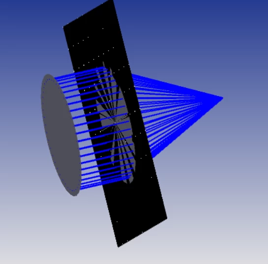

for obj, how about using a slide surface?
Yang
  • Aug 3, 2025 7:46 AM UTC
Thank you yang,
The slide surface can defiantly help 👍
