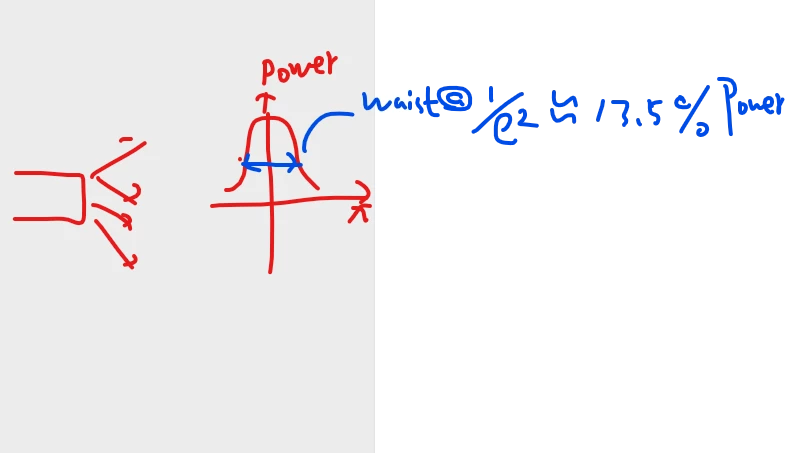

Waist X and Waist Y are each semidiameters. Each should be ½ of the mode field full diameter. That will describe the single mode of the fiber as a Gaussian with 1/e^2 intensity at the waist edges. Optimal coupling will occur when the beam profile presented to the fiber matches this mode.
Hi Julien, for your reference
