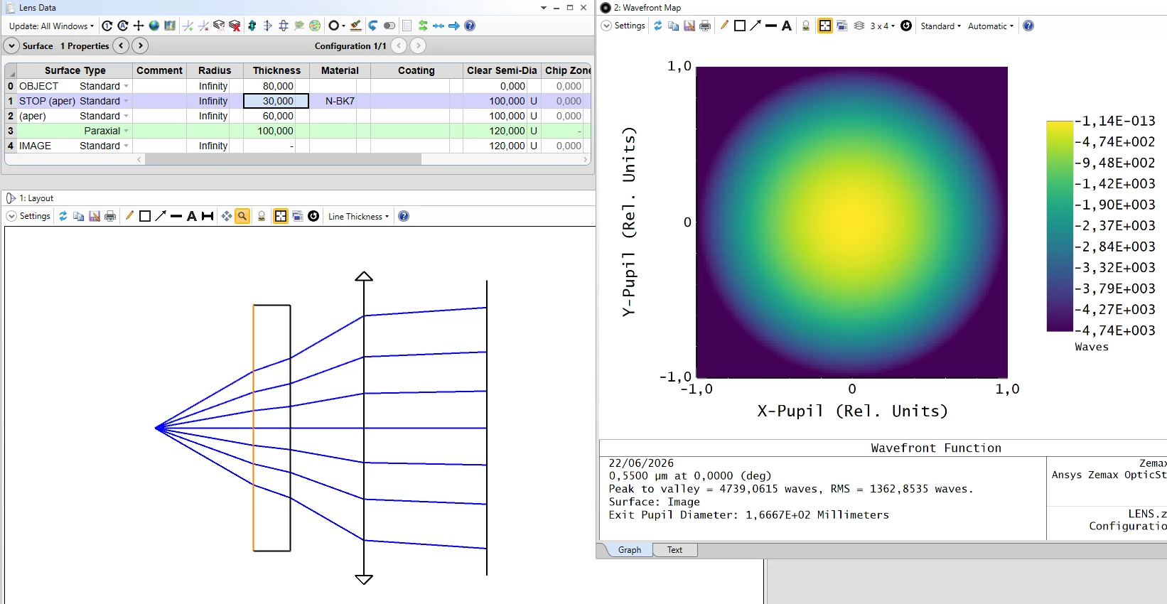

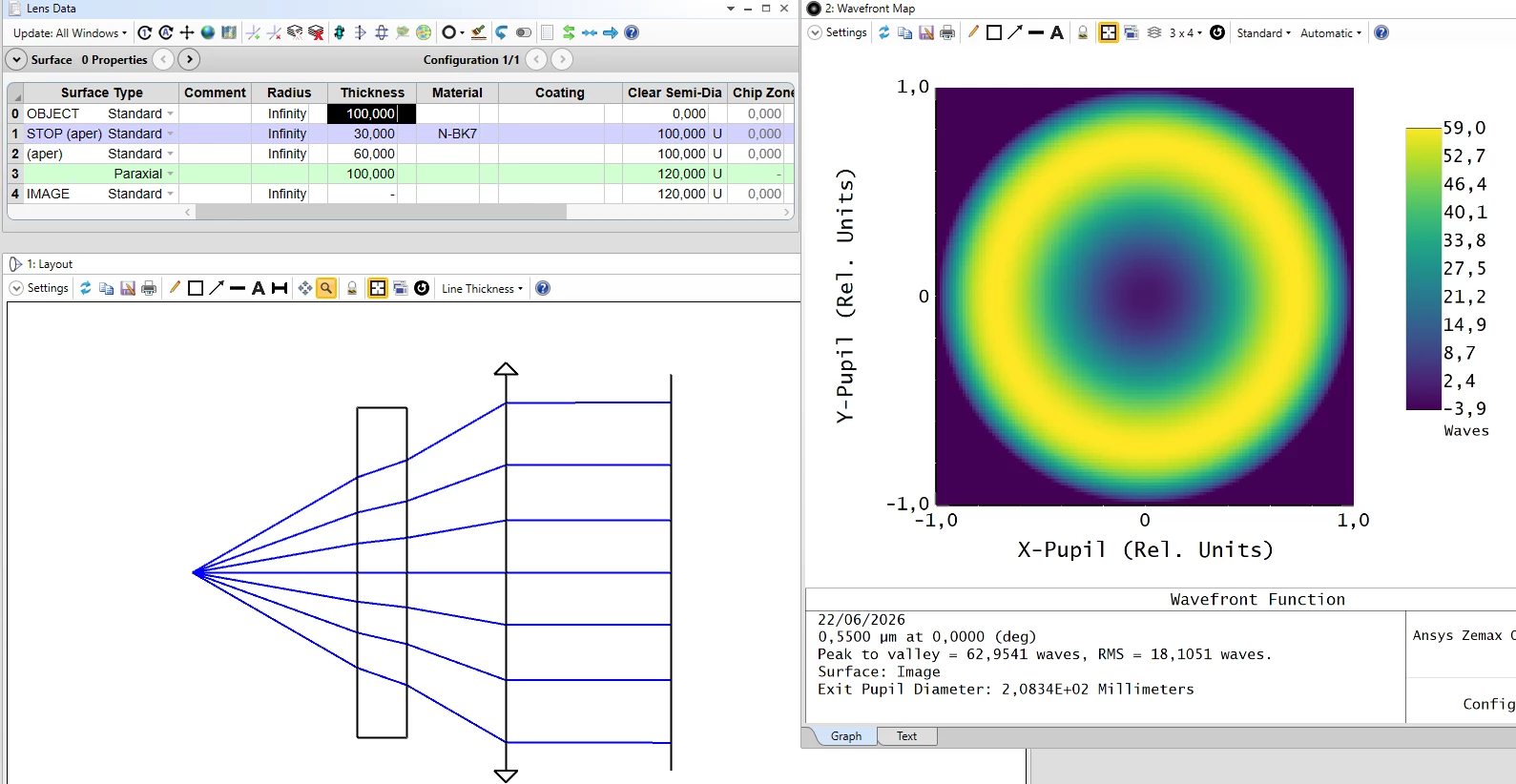

Thank you very much for your reply. To clarify my point, I have built a simple dummy system in Zemax with afocal image space. In the nominal configuration (object distance = 100 mm), the wavefront map is dominated by spherical aberration, with PV = 62.95 waves.
When I reduce the distance from the object to the parallel plate from 100 mm to 80 mm (which is equivalent to moving the beam splitter axially closer to the preceding lens in the vertical arm of the real system) the wavefront error increases dramatically to PV = 4739 waves, now dominated by defocus.
This is why I am concerned about the axial sensitivity of the system: a lateral decenter of the beam splitter inevitably induces a longitudinal displacement δz in the perpendicular arm, shifting the beam splitter closer to or further from the preceding optics and introducing a significant defocus contribution to the wavefront error.
