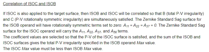

I think the reason you are seeing different sensitivity results for ISOC (depending on whether or not ISOB is also used) has to do with the correlation between ISOB and ISOC.  As noted in the help documentation:
This means the Zernike coefficients used for ISOC during tolerancing will be different if ISOB is also included in the tolerance listing (prior to ISOC).  You can use a SAVE operand after any other given operand of interest in the TDE to see the details.  Lastly, note that the order matters.  I observe a difference if ISOB comes before, compared to after, the ISOC operand.
