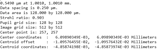

For some reason, I am also interested in the sum of incoherent Huygens PSFs at the image plane from multiconfigurations. In my case, I attempt to sum different PSF from different fields (with the same wavelength but different incident angles).
I wrote a Python script to do this, but I'm a little confused about which reference to use for the sum. Michael mentioned the centroid offset as the reference, but it's the center coordinates that are highlighted in the image provided.
So my question is, what is the difference between the center coordinates, the centroid offset, and the centroid coordinates given in the output text file?
For now I’m using the center coordinates as reference but i’m not sure since it seems to be the chief ray position on the image plane. What if I use centroid instead of chief ray?

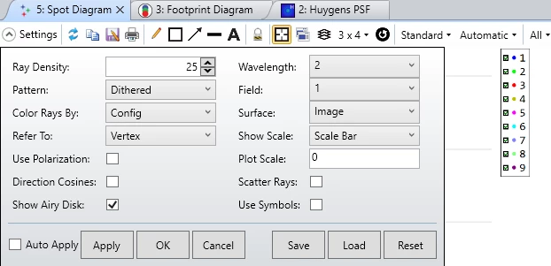

Ideally, I would like to compute the sum as the spot diagram compute the total spot size when it refers to the vertex.

Hi Sedick,
The original post was more about writing your own 2D bilinear interpolation and I should have been more clear when writing the post between “center” and “centroid” since the Huygens PSF Text tab uses both. The coordinate you need to align between different PSF grids is the highlighted value: Center coordinates. And yes, this appears to simply be the Chief Ray coordinate (I only tested on a handful of “well-behaved” files, but you should verify the REAX/REAY operands match up with the Center coordinate for your system).
Basically, when you’re aligning different grids, you need a universal reference. All the values that the Huygens PSF data give are with respect to the center of the data grid so in order to compare 2 different data grids, you need a common reference point. The Center coordinates translates the center of the data grid (located at n/2 + 1 pixel) to the common reference of the image vertex.
- Center coordinates: the center of the data grid with respect to the image vertex (this is calculated before the actual Huygens PSF calculation is performed and is needed to determine the location of each binned pixel for the PSF calculation)
- Centroid offset: the offset of the Huygens PSF centroid with respect to the data center (this is performed after the Huygens PSF calculation)
- Centroid coordinates: the location of the Huygens PSF centroid with respect to the image vertex (this is typically what a user cares about in a lab setting)
One thing to note is you should make sure Normalize is unchecked so that you’re actually getting real values for each configuration and you can sum them incoherently.
