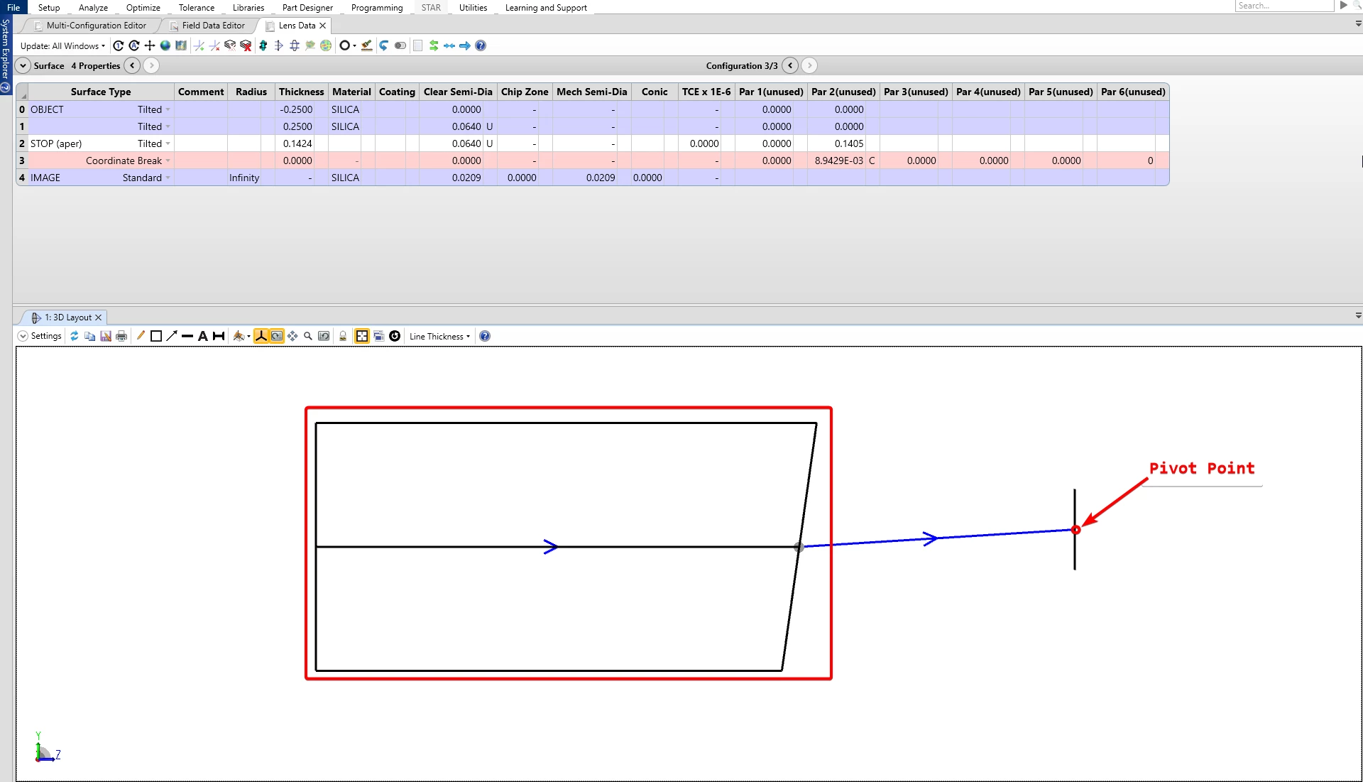

From this KB it is clear that we can pivot an element about any arbitrary pivot point in space.
This is Ok for intermediary optical elements in the optical chain but breaks when you want to pivot either the Object of Image surface.
Here is a an example showing a simple Optic Fiber with Chief ray centered on to Image surface. How can I pivot Surfaces 1→3 about the Pivot point centered on the Image surface?
Hi Asuku,
This can be done by shifting the pivot point to image plane.
Shifting the pivot point can be inside or outside the optical system.
A ppt demonstrating the shifting of pivot point and a sample zemax file is attached for reference.
Hope this helps!
Take Care!

Thank you for the PPT. It did help!
