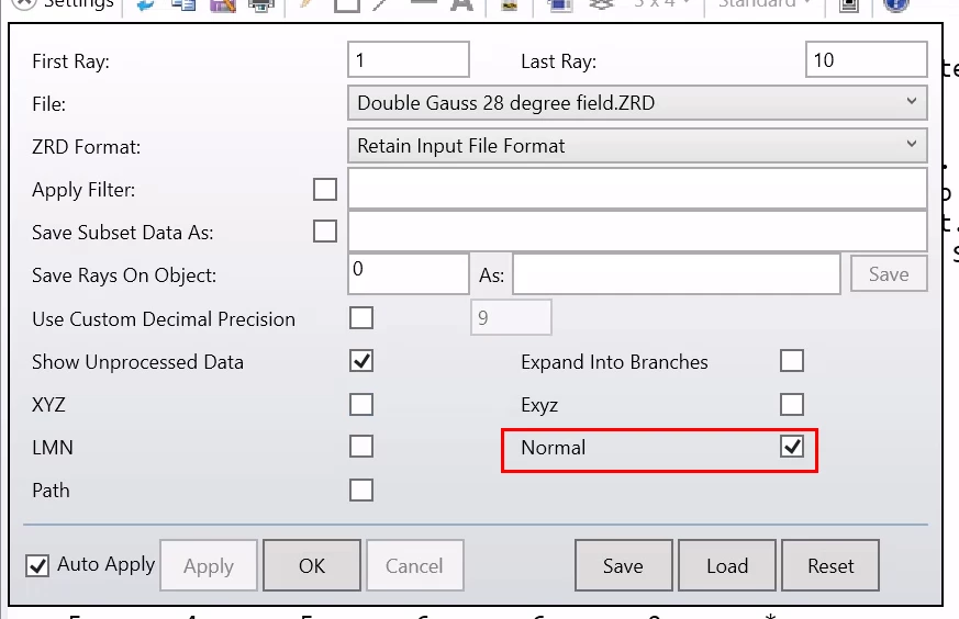

Can you save a ZRD file and use the Normal section of the Ray Database Viewer?
