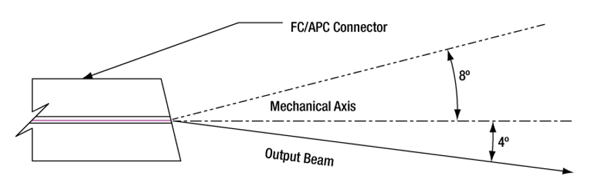

Hello. I am trying to model a Angle Cleaved fiber source that emits beam. I would like to show the exit beam is offset at 4° from the optical fiber mechanical axis. How can I model this in SEQ mode?  Essentially, I want to model something like shown below in Zemax Sequential mode.
PS: I am referencing this KB article to model a Angle Cleaved fiber on the receiving side.

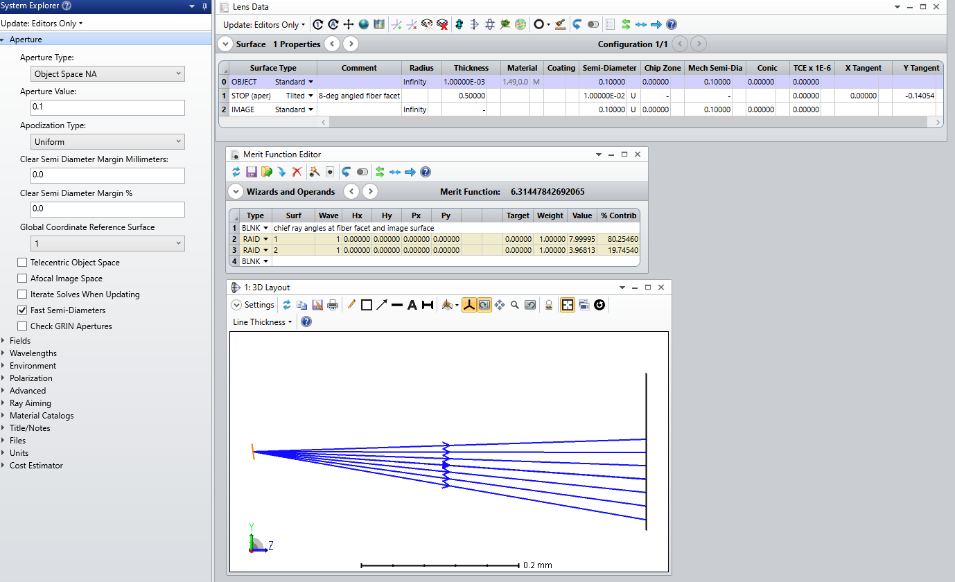

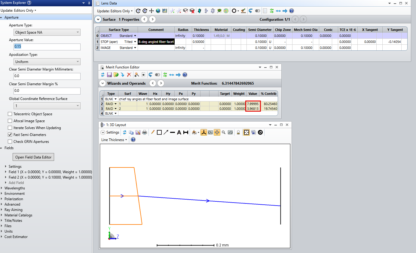

I like to use the Tilted surface:
By making the object surface thickness very small, say ~1 um or less, you can simulate an angled-facet fiber source:
  • Apr 30, 2025 9:31 PM UTC

​@Jeff.Wilde  Thanks Jeff. That made it very clear.
