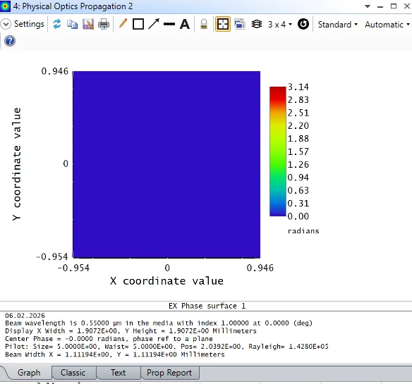

Thanks for sharing. I simply checked the attached zbfexample.zbf file in Zemax. The phase is 0, should it be 0? because I see in the attached excel table the phase of Ex is non-zero.
