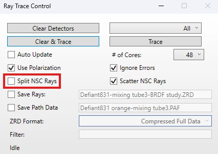

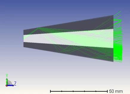

When we use BRDF file for reflective scatter on reflector or hollow pipe inner surfaces, I normally set it like this to split incident rays to 50% specular and other 50% diffuse scattering.
Question is then should we use "ray split" option in the ray trace control below? If this box is unchecked does Zemax not produce secondary scatter when first scatter rays bounce again off the reflecting surface?
I copied screen shots of these settings and 3D view of the hollow pipe model for testing it below.

Hey JS,
In general, yes, you need to have Split NSC Rays checked when performing an operation like scattering where you one incident ray to become multiple output rays; otherwise, OpticStudio will only trace the specular ray from the interface.
In non-sequential ray tracing, each segment of a ray is ~208 bytes (I think it has increased in recent releases to around 240 bytes with a few more values being tracked), so always enabling ray splitting can be a costly decision that potentially crashes OpticStudio if you’re tracing a lot of rays on a low-powered computer.  With ray splitting enabled, every ray-face interaction produces two segments, so this is an exponential growth when a lot of rays or a lot of surfaces are present.  According to the Help Files, even a small number of rays of 100,000 with 50 segments (50 ray-face interfaces) produces a ZRD file that is 1Gb.  So, to provide flexibility to the user, ray splitting is off by default but can be enabled for both Layouts and Ray Tracing.
Note that simply checking Split NSC Rays might not produce the expected results in your case.  There are other considerations like minimum relative ray intensity, the NCE nesting rule, TIR (scattering is ignore for TIR interactions), and other scenarios that might affect the expected result.  If checking Split NSC Rays does not produce the expected results, I would recommend sanitizing your file and uploading it to this forum so other members can help to identify the root problem.
~Michael

Thanks for your feedbacks on this question. Yes, I’m aware of memory impact of turning on the ray split in the ray trace control. So, I normally have the “simple ray splitting” checked in the non-sequential system explorer, which will have Zemax handle the ray split on every surface in statistical way instead of doubling the specular rays at each refracting surface. So, it conserves the total number of rays during the ray trace.
After posting this question a few days ago I tinkered with some combination of settings and got these two main observations. “Simple ray splitting” is checked in all cases.
  1. If the ray split box is off in the ray trace control and scatter fraction is somewhere under 1 like 0.5, the reflective scatter surface with BRDF will still scatter, but in statistical way. So for 100 incident rays to scatter surface 50 rays will reflect in specular direction and other 50 rays will go in scatter directions. So this setting combination won’t increase the total number of rays traced, but signal to noise ratio won’t be great unless I use larger number of source rays.
  2. If the ray split box is check on in the ray trace control and scatter fraction is like 0.5, Zemax will create extra scatter rays defined in number of scatter rays box in addition to the main specular reflection ray. So this setting will make more total rays depending on how many rays is set in the number of rays for BRDF scatter.
I have found the setting 2 above will result in better signal to noise in the color detector showing mixed color from the multi-color array sources for the same name of source rays.

What about the case of reflective BRDF scattering in mixing hollow tube with ray split set to off?
For the example above with BRDF set to scatter 2 rays per incident ray and scatter fraction 0.5, I think it would make 500 rays scatter off the reflecting surface out of 1000 incident rays. Other 500 incident rays would just reflect off the reflecting surface in specular way. In this case does 500 specular reflecting rays and 500 scatter rays from the first bounce would do the same probabilistic reflection/scatter in the following bounces in the hollow tube?
