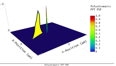

 I am learning about birefringent materials, and my question is
 How to confirm the focuses resulted by birefringent material at the same time?
the image expected is below
Best regards
Yang

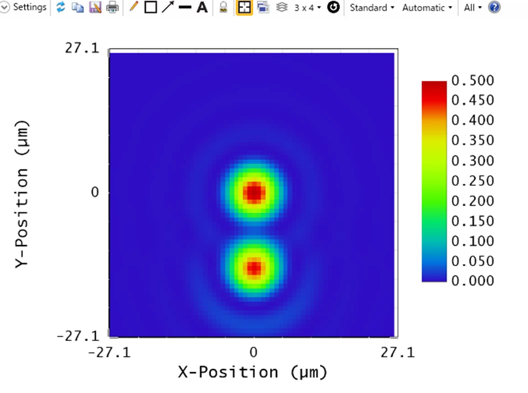

Hi Yang,
Yes, you found the solution I was going to recommend.  Basically, using a Birefringent Surface is the same as using a multi-Config system and there are only a handful of analysis that support multi-config systems.  Any ray based analysis can simply be superimposed in a multi-config system to provide the output, but if you need a diffraction based multi-config analysis, the Huygens PSF with Config=All is one of the most powerful tools that OpticStudio has.  I would avoid any pupil-based calculations including FFT analysis because there is no “common” image-space reference point to superimpose the results onto a common plane.

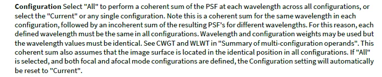

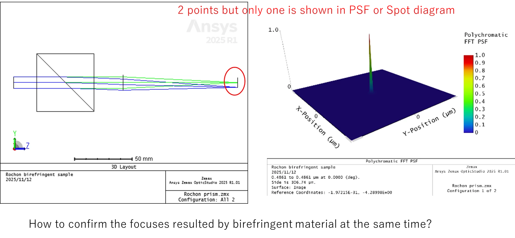

Sorry for bothering
 Huygens PSF can deal with this issue

Hi Michael
 Thanks !Actually, I am comparing the functions between CODEV and Zemax, and find that, in Code V it seems there only one method to calculate the PSF, possibly it is the Huygens PSF. it directly output a 2 points spread function result.
