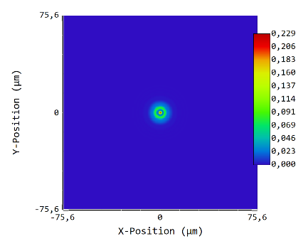

In OpticStudio, the PSF resolution depends on the ratio D / S. D has to be in the range [S, 2S] and choosing D < 2S appears to crop or zoom the PSF, so OpticStudio does not allow to adjust the ratio D / S. As a result, assumption 2 cannot be tested by increasing D, but we can test assumption 1. I performed this test on the ‘Cooke 40 degree field’ sample.

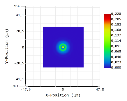

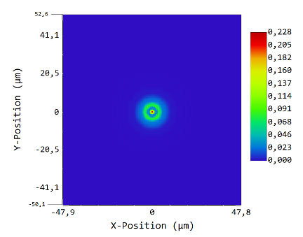

Let’s start with S = 64x64, D = 128x128:
dx = 0.818 μm, data area is 104.759 μm wide.
Now decrease D to 64x64:
This indeed only crops the PSF. dx remains the same.
Now increase S to 128x128 and D to 256x256. D / S remains the same, so the extent should not change, but S is doubled, so dx should be halved. Result:
dx = 0.588 μm, data area is 150.541 μm wide. dx is not halved, so assumption 1 is not true; furthermore, the PSF extent changed, so assumption 2 is also not true.
