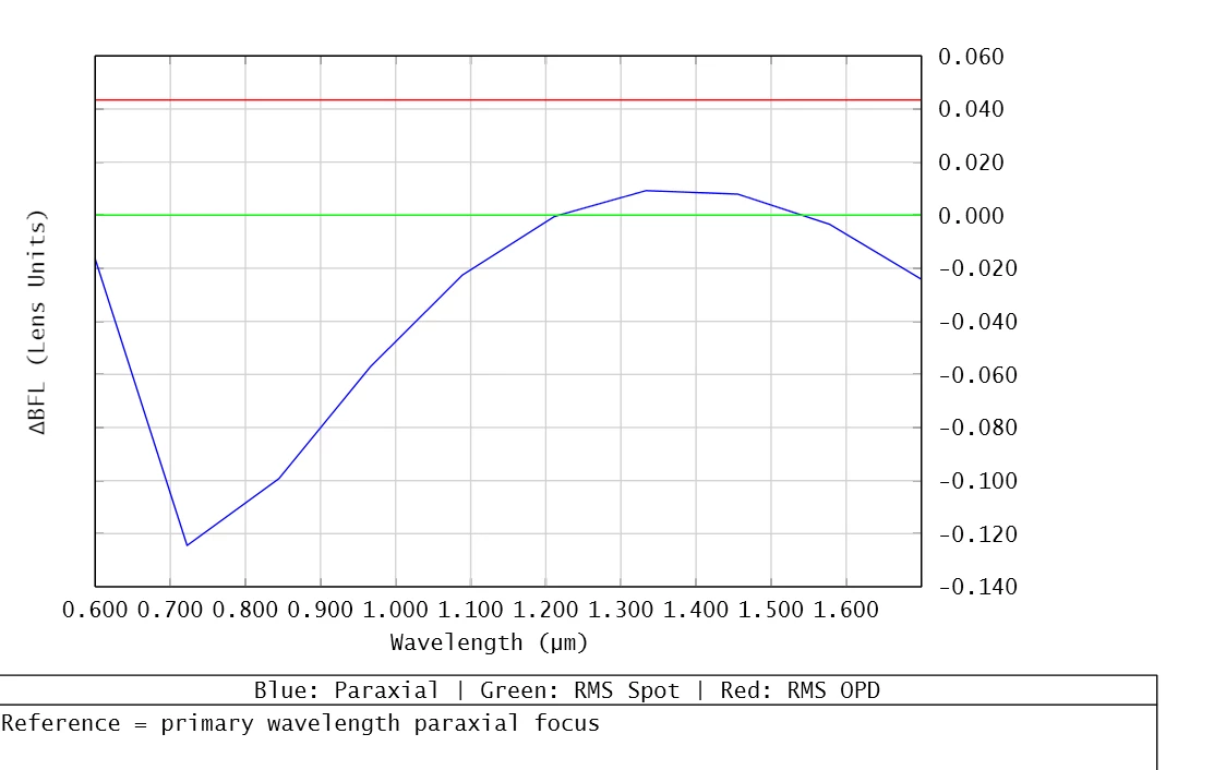

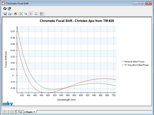

Specifically, I want to create a graph in Zemax that combines Chromatic Focal Shift and Wavefront Error Best Focus, similar to what CodeV provides.
What I have tried
Method 1
  1. Use a ZPL(Attached+Merit function) script
    ZPL Merit Function
    to calculate the wavefront-error best focus and generate a plot (Fig. 1).
  2. Generate the Chromatic Focal Shift plot (System) (Fig. 2).
  3. Overlay Fig. 1 and Fig. 2.
    → This attempt failed.

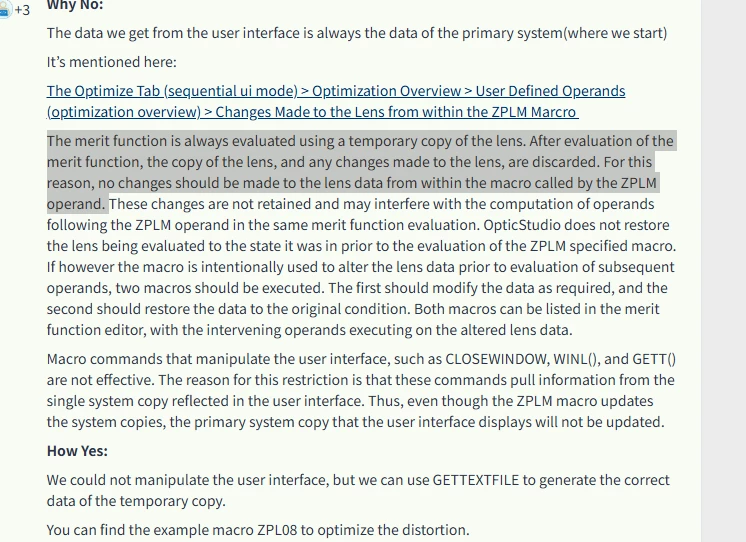

  1. Use the Universal Plot feature with ZPLM data to generate the required plot.
  2. Overlay it with Fig. 3.
    → This also failed at step 1 (some operands cannot be computed).

Best answer by Mike.Jones
Try this.  It does what CodeV does, but the graphics are 1980-quality.  Better to export array values to Excel where you can actually make decent looking plots.
Just my style: As you see, I always copy pertinent parts of the manual to my ZPL code so I don’t have to keep going back and forth.

Hi Mike,
Thanks!
With your help, I managed to write a new ZPL as shown below.
I’m just wondering—does Quick Focus work the same way as optimizing with a Spot Merit function? It feels a bit tricky…
# CHROMATIC_FOCAL_SHIFT_PRIMARY_PARAXIAL_REFERENCE_FINAL.ZPL

# 4) Plot: Chromatic focal shift
PLOT NEW
PLOT TITLE,  "Chromatic Focal Shift (Primary Paraxial Reference)"
PLOT TITLEX, "Wavelength (µm)"
PLOT TITLEY, "ΔBFL (Lens Units)"
PLOT BANNER, "Blue: Paraxial | Green: RMS Spot | Red: RMS OPD"
PLOT COMM1,  "Reference = primary wavelength paraxial focus"
PLOT RANGEX, w1, w2
PLOT DATA, waves, dBFL_parax, nwaves, 1
PLOT DATA, waves, dBFL_spot , nwaves, 2
PLOT DATA, waves, dBFL_opd  , nwaves, 3
PLOT GO
