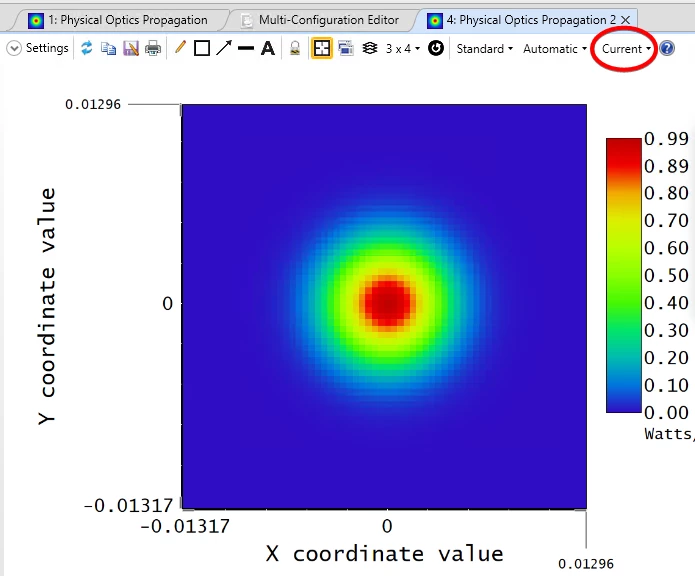

POP settings after running the code above (and not closing the POP window).
While most settings of POP can be read from the Syntax Help File, some parameters are hidden behind parameter numbers. This is the purpose of the (settings) methods: GetParameterName, GetParameterValue, and SetParameterValue. I’ve added a small piece of code that shows the parameters available and their corresponding numbers. You don’t need that piece of code in the end, but here’s what it shows:
Parameter number: 0 | Parameter name: Waist X
Parameter number: 1 | Parameter name: Waist Y
Parameter number: 2 | Parameter name: Decenter X
Parameter number: 3 | Parameter name: Decenter Y
Parameter number: 4 | Parameter name: Aperture X
Parameter number: 5 | Parameter name: Aperture Y
Parameter number: 6 | Parameter name: Order X
Parameter number: 7 | Parameter name: Order Y
So when you call the SetParameterValue with paramIdx as 0/1 you are setting the beam X/Y Waist respectively.
Let me know if that makes sense or if you need further explanation.

  • Jul 30, 2025 2:35 AM UTC
​@David.Nguyen Hey David, thanks for the example you provided. I was wondering if it is possible to control/change the multi-configuration control found in the POP analysis window. How would I be able to save beam files for different configurations?
