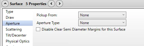

In the first sentence, “… have no aperture defined...” refers to the surface’s Aperture data ? so that means “for surfaces whose Aperture data is None for Pickup From and Aperture Type” ? - like so :
Then, “to have a circular aperture at the current clear semi-diameter” : from what I understnd, with “Clear Semi-Diameter” solve as Automatic, the value of a surface’ clear semi-diameter is computed at the appropriate height so that it does not vignette any ray. so I don’t understand how or why a ray in the image simalution would go beyoud this height.
