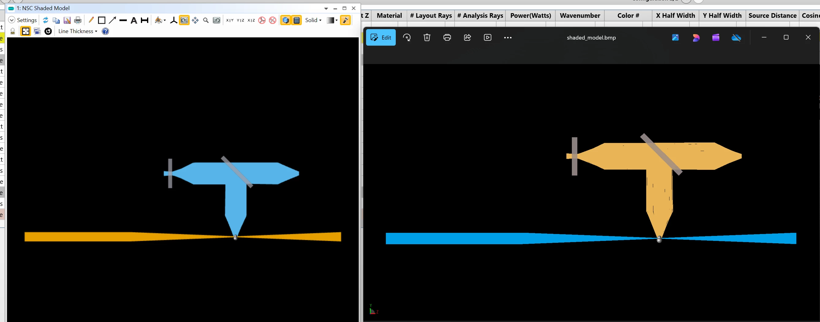

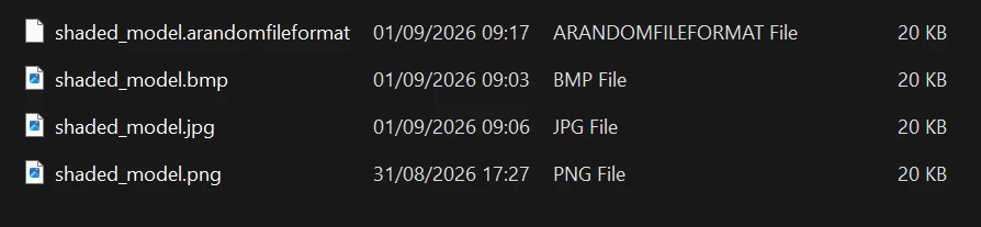

File format specification
As far as I understood, simply changing the extension in OutputFileName should be enough to change the file format. I tried the same file name and changing only the extension: .jpg, .bmp, .png. However, all the files have the exact same size, and when doing a binary comparison of the file, only uuid and updatedAt are different, the content is the same. I was trying to use IsValidFileName but this seem to always be False. Also, I can use any extension and a file will be created.
PDF format output
I like the new PDF format for saving the layouts, but it is not available in the API.
Change in colors
This is minor but the colors for me are not exactly the same as in OpticStudio when exported (the colors are inverted but at this point it is not so important).
