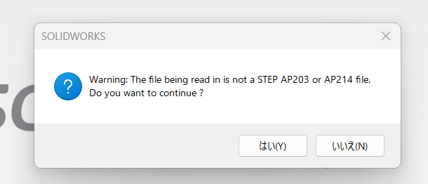

Hi Zemaxers
 When i am checking the step data exported by zemax, the solidworks shows the error.
and failed to open the data.
BUT, when I checked with my old step data exported by zemax(around 2022 year), it works well!
my version is  Ansys Zemax OpticStudio 2024 R1.03
Do you also meet this problem?

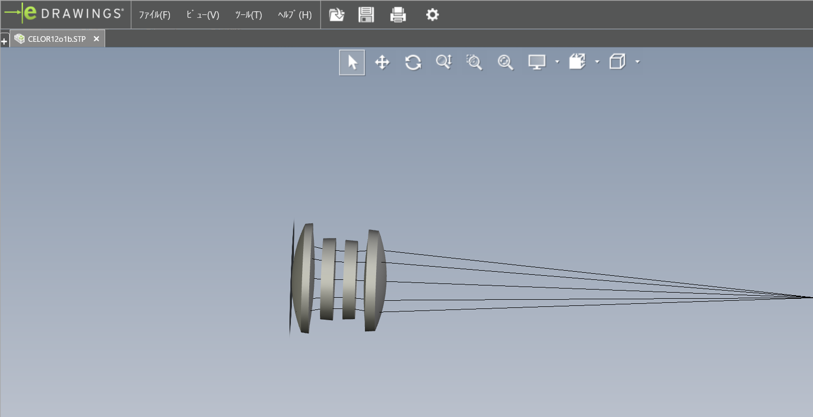

by the way,  eDrawings 2022 x64 Edition can open the data well ...

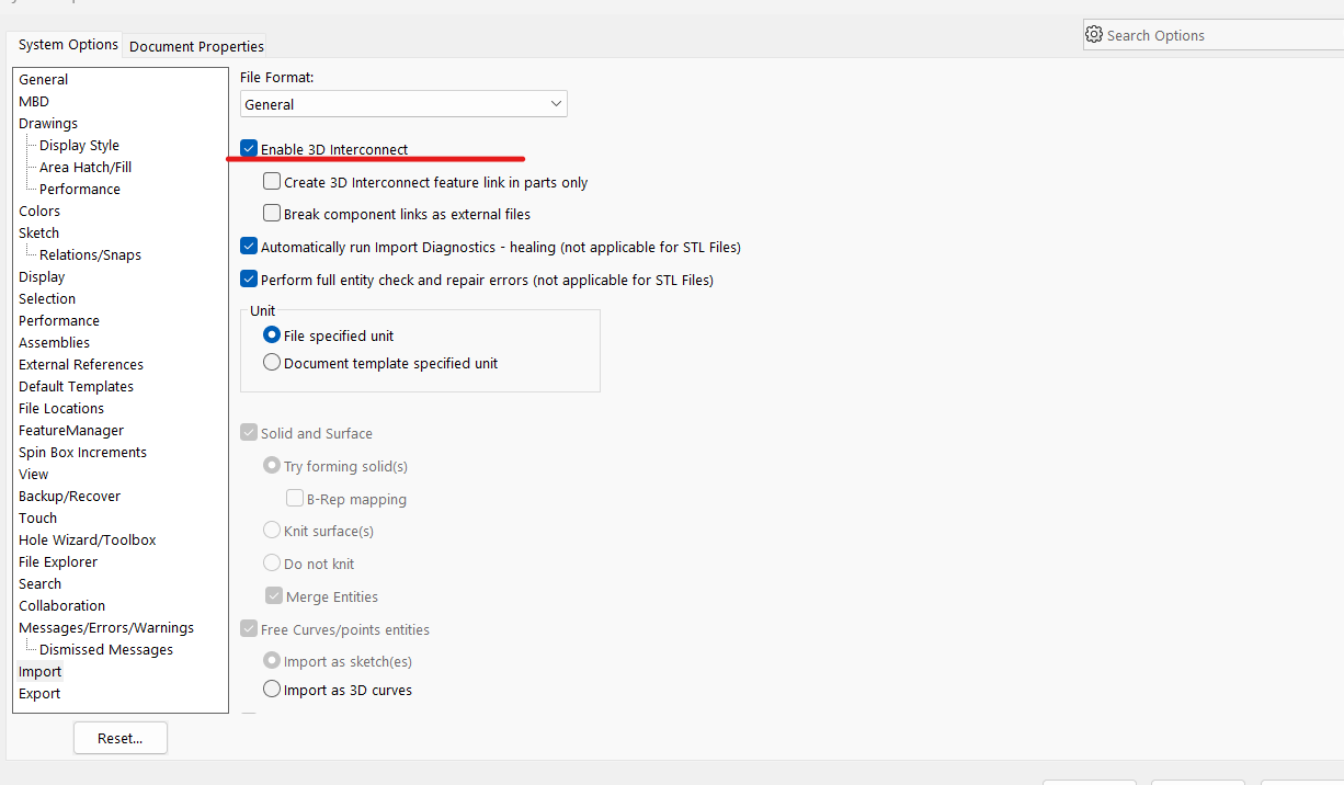

this is the solution.
  • Apr 24, 2025 5:05 AM UTC

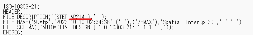

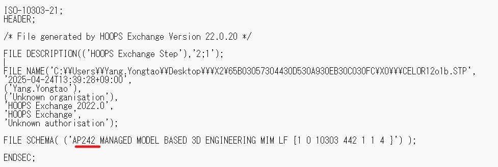

seem the current CAD export in Zemax output a AP242 format
my former data is
so the Enable 3D interconnect is necessary
