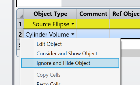

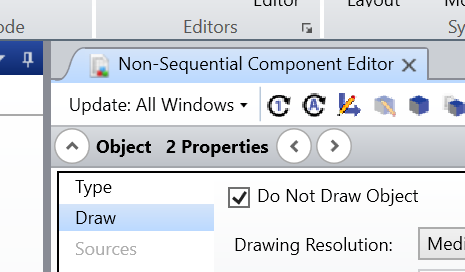

In addition to Ignore Rays you can also opt to Do Not Draw Object such that said object doesn’t appear in the Layout anymore.
There’s a handy feature in the NCE that will do both Ignore Rays and Do Not Draw Object if you right-click on an object or a selection of objects:
I hope this helps and take care,
