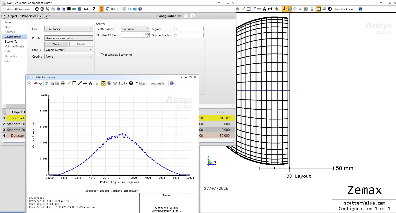

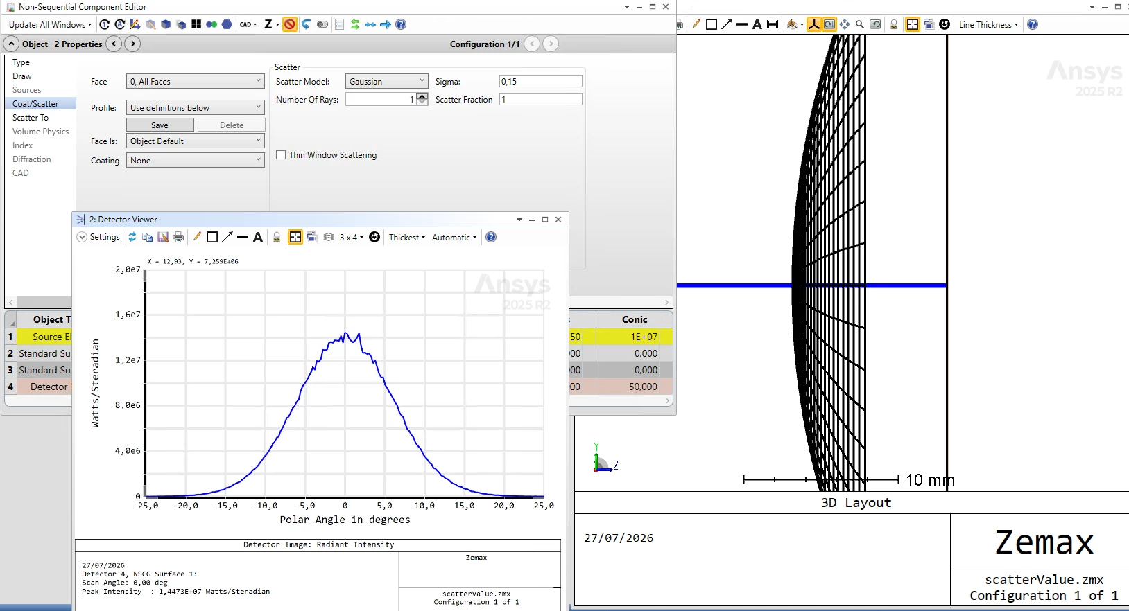

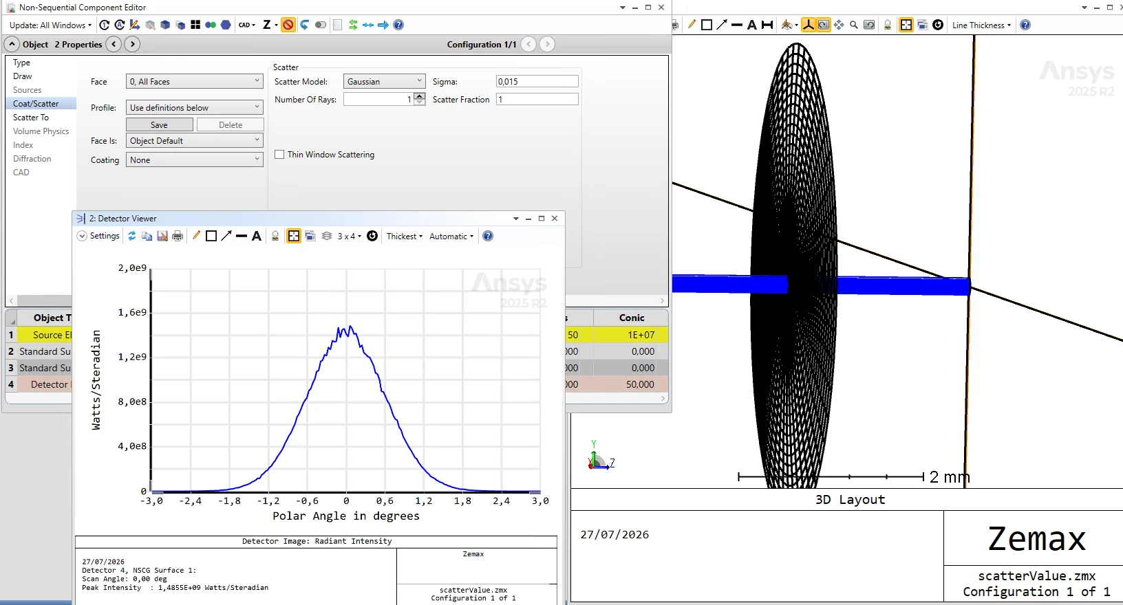

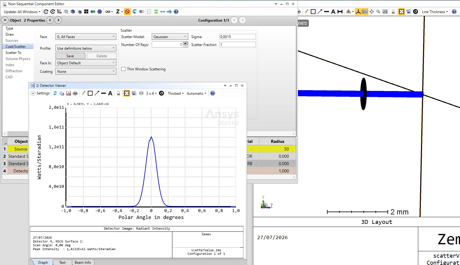

I just ran into the same issue. Has anyone found the relationship between the sigma value and the angular distribution? I modeled different sigma values across a range of angles with a Detector Polar and found an almost linear relationship up to sigma = 1, where the linear behavior breaks down.
Figure 1. Gaussian sigma = 0,0015.
Figure 2. Gaussian sigma = 0,015.
Figure 3. Gaussian sigma = 0,15.
Figure 4. Gaussian sigma = 1.
Has anyone figured out how this sigma value actually works?
