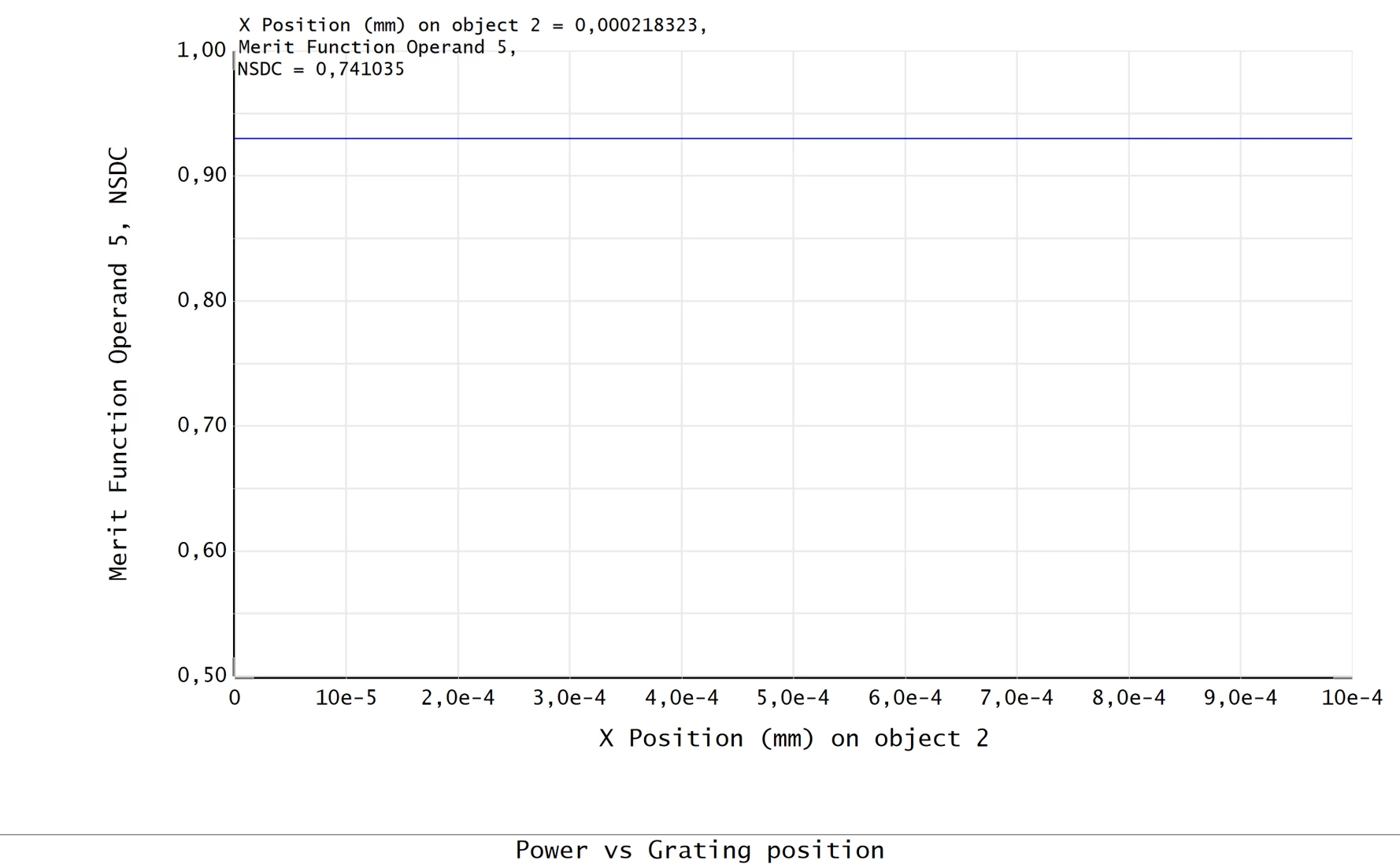

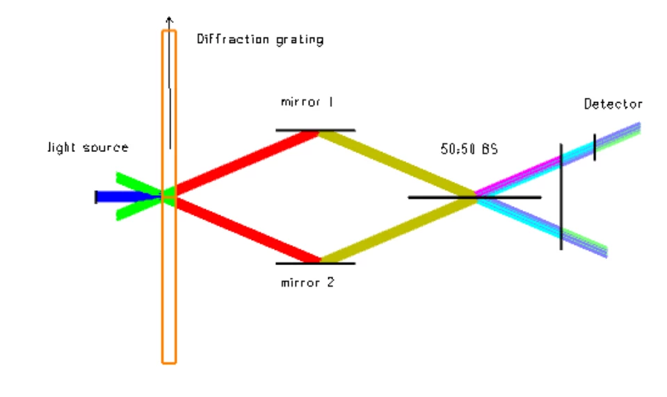

Hi All, could someone please clarify how to observe a phase shift, that is induced by a moving diffraction grating?
In the layout (see the image), the grating is moved parallel the light source. The defined diffraction orders of the grating are +1 and -1. By recombining the diffracted light, I would expect intensity change due to interference as a function of a gratings position. However, this is not the case, and the intensity remains constant (see the graph).

​@Andrei:  It looks like you are translating the grating in the x-direction.  Perhaps you should try the y-direction?  If that doesn’t work, then if you provide a copy of your model file it would help for debug.

In my example the graphs should have been showing translation along the Y, but I was getting the same results for both X and Y translations.
I adapted your example to use a source ellipse for a collimated beam. It still worked for a single pixel detector, but when I changed to multiple pixels, it produced results  I was getting before. Apparently according to Zemax Help, there is a Normalize Coherent Power checkbox in the object properties that must be ticked off. Otherwise, the total power on the detector is normalized in such a way that it appears constant.
