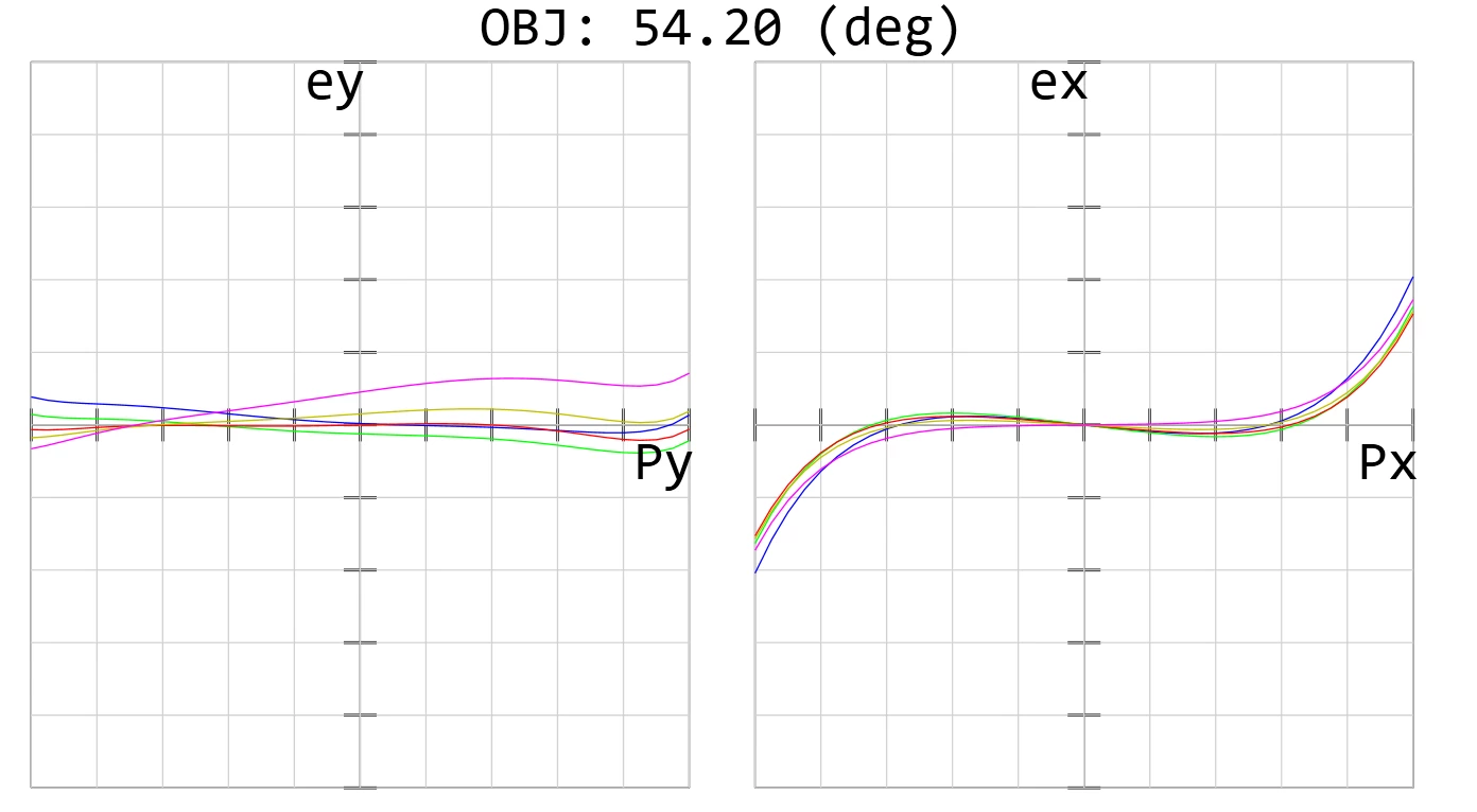

Please could you magnify the central part of the ray aberration curves  @ max field & tangential plane (ey) ?

Here is the magnified version of the ray aberration curve at max field.
Tried different options like changing the materials, design approach and all. The bottle necks are front lens diameter, Knoop hardness >450HK, TTL and wavelength range.
Actually, I got good results for 486nm to 656nm wavelength. But the requirement is from 436nm to 656nm.
I’m looking for an out of the box suggestion to use the tool more effectively.
Thank you very much for your support.
OK
  • the lenses are too thick (rule of thumb : thickness ~ diameter /10). This could help for TTL.
  • are there aspheric surfaces ?
  • did you try to separate L6 and L7 ?
  • did you try to move the stop ?
  • for sports applications, do you really need 436 nm ?
  • from CFS and ray aberrations : try to increase the Abbe number of L8
  • ultimately : change the starting point. See for instance “Modern lens design”, W. Smith
